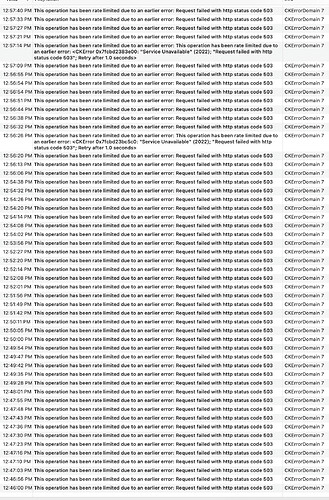

I'm seeing "Request failed with http status code 503" CKErrorDomain 6
For reference, I unchecked all databases except one. I limited connections. Above 4 connections and I get errors and apparently no transfers. At 4 connections, I transfer bursts of dozens of files. Below 4 connections, I get the same duration bursts, but fewer files transfer. 4 seems to be the sweet spot.

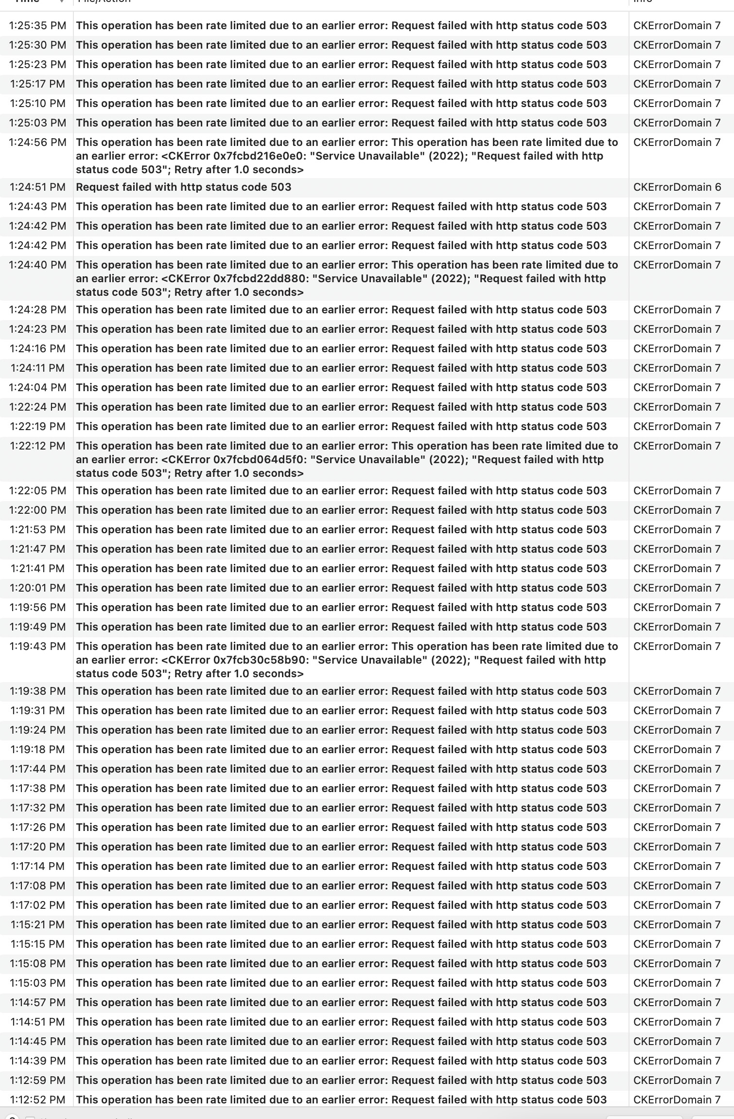

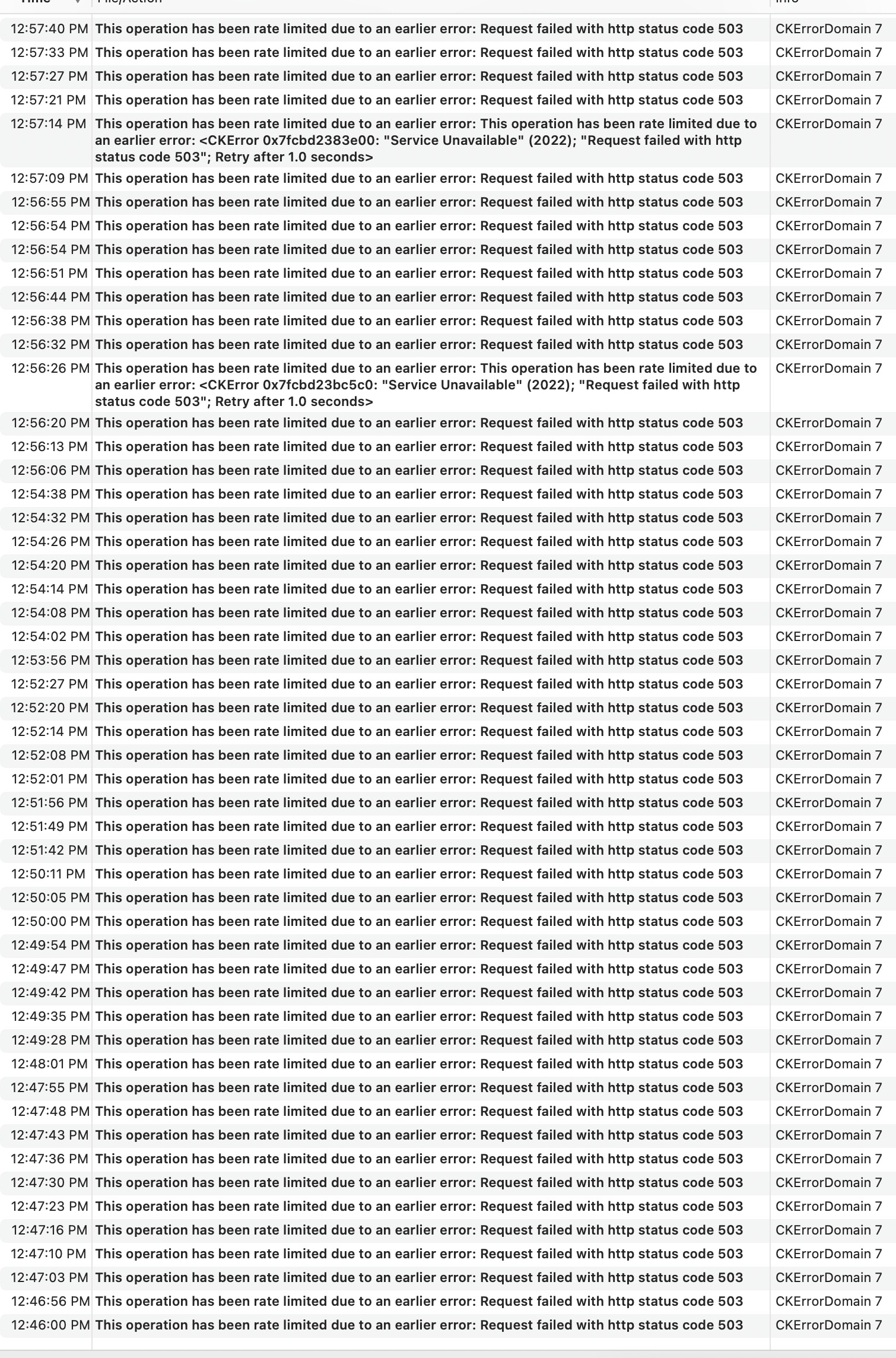

Before I reduced connections and databases, as best I could tell, DevonThink wasn’t actually transferring any files at all and was producing a steady stream of errors. (attached below)
With one database and 4 connections, I see the files transfer in the spurts. The transfers stop coinciding with 1 or 2 additional error in the log. The spurts are roughly 2 minutes apart.
