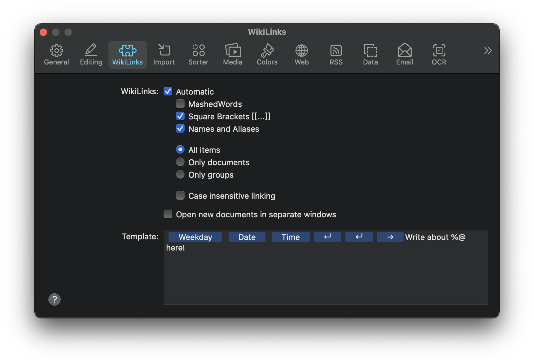

Could you please send the relevant docs to cgrunenberg - at - devon-technologies.com plus a screenshot of Preferences > WikiLinks? Thank you!

A copy of all documents plus a screenshot of Preferences > WikiLinks would be great, so far I couldn’t reproduce this.
