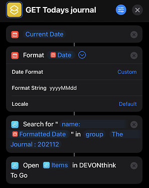

I have a shortcut that I use as a subroutine to call from a few shortcuts to make additions to my daily journal entry. All my journal entries are markdown files, created by a shortcut, with the title format yyyyMMdd. As you can see from this screen grab, it formats the date, searches for “name:formatted date” in a group called The Journal (which is actually the database name but specifying an actual group makes no difference). Then it should open the one resulting file. (I’ve done the search manually in DTTG - there is only ever one result for any date)
The problem I am having is that it:
- doesn’t limit the search to just that group or even that database and
- presents me with a list of almost all recent modified files to choose from, from all open databases, regardless if their name contains a formatted date or not.
Thanks
I’m very new to Shortcuts so I’m not best placed to help with this, but…. Am I wrong to say your shortcut doesn’t contain an instruction to search for the current date? I have a shortcut for opening today’s current journal entry, and it has an explicit line that says “search current date” which you don’t seem to have? (You seem to be instructing it to search for a specific “date format”, not the actual date?)

Well, it should find the document based on the provided name and open that document. Am I safe to assume that when it fails the Search
action simply does not return any document which is why you’re then asked which document to open?

Hmm, do you still use the query depicted in the opening post?
The shortcut has been modified a few times.

Here’s a link to the most recent version of the subroutine that I call from a few different shortcuts
