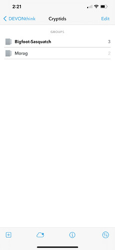

And you’ve looked in the Global Inbox for emboldened items? That’s the other indicator of something being unread.
For example…
:smiley:

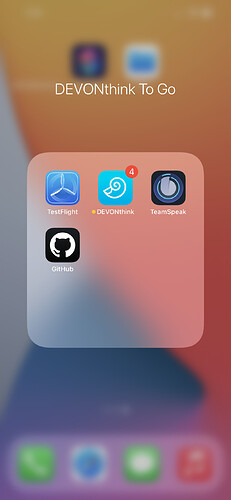

Hey :slight_smile: Not sure what you mean when saying that; is it not the case that databases/groups containing unread items are displayed using the bold attribute? In addition, the number of unread documents is displayed to the right of the name of the database/group, also bold (as opposed to the total number of documents, shown when no unread documents are present). I think you are correct in saying that there is no indication that the badge on the app icon represents unread documents; I think that isn’t even mentioned in the handbook. On the other hand, I also thought that this badge behaviour is the standard for iOS - in that I would have expected the badge to mean exactly that. Is your experience or expectation different, or have I misunderstood you?
Sure, if you know what it means, you know what it means. :smile:
The badge is just a notification dot. If it showed the unread count (ala Mail) then I probably would have figured it out. But as a generic indicator, it could mean anything. In the other apps I use, it often means there is something that needs attention.
And a slight adjustment… it’s unread items in the Global Inbox :slight_smile:
Where are you seeing the badge is just a dot?
