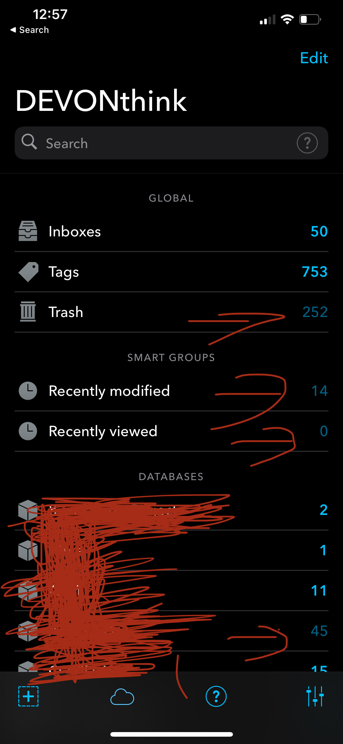

I tried it out today. I’m missing some files, and as you can see in this pic, some folders/tabs are grayed out. I don’t know if that means they haven’t synced, but have no idea how long that will take.

There is nothing showing folders or tabs grayed out (and there are no “tabs” in DEVONthink To Go).
The emboldened number is the number of unread items in a location. The regular text shows the total number of items in a location.
Unread item counts always supersede item totals.
Ok. Thanks for clarifying. That being said, is it normal for the numbers to not sync between applications?
