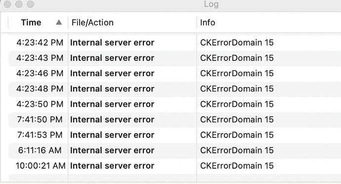

It’s the first mention of the error I’ve seen. Perhaps @cgrunenberg has seen it.
Apparently related to CloudKit: Apple Developer Documentation That said, it looks like it happened just one time at 7:18/7:19 AM EST today (the multiple listings probably corresponding to each database) and hasn’t recurred
Good to know it hasn’t recurred. And yes, it’s definitely CloudKit but I’ve not seen a 15 yet.

I can also report the error “CKErrorDomain 15” in the log in my DEVONthink 3 installation on my Mac.
I’m using the CloudKit sync since some two weeks on all my devices (Mac, Ipad, iPhone) since the release of DEVONthink to go 3. This is the first time I’ve seen this log.
Any help would be appreciated.

All I can tell you is I got it that one time and it hasn’t recurred, so … maybe it’s rare and harmless?
Are you syncing one database at a time?
Are you able to verify the sync store (see contextual menu in Preferences > Sync) successfully?

Yes, but I couldn’t verify them immediately, though (I had to contextual-click several times). I’m not sure if this behavior is new or not, since I very seldom verify the databases. Also, FYI, a reboot of the computer didn’t seem to do the trick yesterday.
Today, however, I do not get any of the errors of yesterday. However, I got the “The operation couldn’t be completed. (CKErrorDomain error 3)” The info column says “Not connected to Internet (CKErrorDomain 3)”, which makes sense since the VPN likely wasn’t up by the time I got the error.
Sorry that I’m not able to give more info or reproduce the error.

I have repeated CKError Domain 15 “Internal server error” notifications now, and DevonThink on the Mac hasn’t synced since Feb 23, not even Bonjour. I suspect that closing it and re-opening it will resolve this, but it’s a concern to say the least.
P.S. Quitting and reopening DEVONthink on the Mac caused it to sync.
This seems to be an internal, temporary issue of CloudKit servers.
