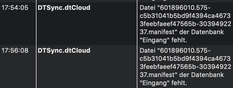

And no issues logged on the Mac or iOS?
none on iOS, MAC log now shows several XXX of this kind:
11:54:03: DTSync.dtCloud Datei “601896010.575-c5b31041b5bd9f4394ca46733feebfaeef47565b-3039492237.manifest” der Datenbank “Eingang” fehlt.

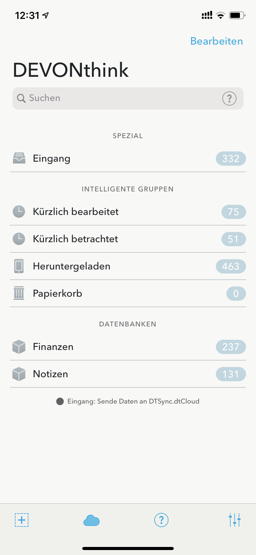

thanks and sorry for the lack of accuracy in my question. What I meant to ask was if there is a manual way initiate synching in DTTG?
No worries.
Touch the sync icon in the bottom toolbar
Pull down on the Home screen or item list
thanks, that’s what I did intuitively, I just wasn’t sure if anything is happening in the background - sometimes the cloud symbol is filled with blue, sometime only partially, sometime nothing seems to happen…
Yes, the sync icon will fill up during periods of sync activity.
