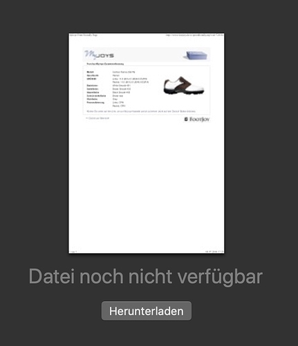

  1. Also, some database items appear to have received a cloud symbol, apparently indicating that the file is not yet available… but it never becomes availble…?
1
  1. A recently solved (or so I thought) sync issue reoccurs - sync has been working flawless until DT3 upgrade using the same setup… at least DT3 was the only change made to the system…

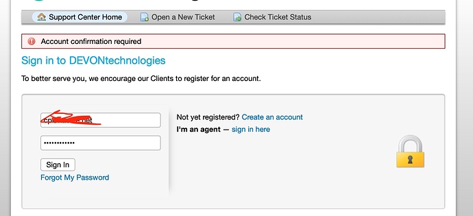

  1. I tried to open a support ticket yesterday and filled out the form, but:
  • I never received a confirmation email
  • thus I did not receive a ticket number (neither was it shown on screen
  • and thus I would not be able to check the ticket status
DEVONtechnologies Support.pdf (56.4 KB) DEVONtechnologies Support-1.pdf (194.7 KB)
  1. I could not log into my account to recreate the ticket as I allegedly have never validated my account…

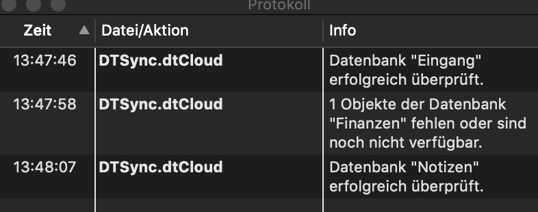

The other issues are probably results of this issue. What kind of sync store do you use? Are you able to successfully verify it (see contextual menu in Preferenes > Sync)?
Otherwise yes
And where is the sync store located?
it´s stored on a Synology NAS
And the sync store is a local sync store located on the mounted server volume or a WebDAV sync store?
The database “Finanzen” inside the sync store seems to be damaged. You could clean the database from the sync store via the contextual menu in Preferences > Sync. Afterwards it’s necessary to upload the database again.

Cleaning the database (using Datenbank leeren from the contextual menu?) has solved the issue before (at least this one:
), but none of the DTTG entries has been synched even since…

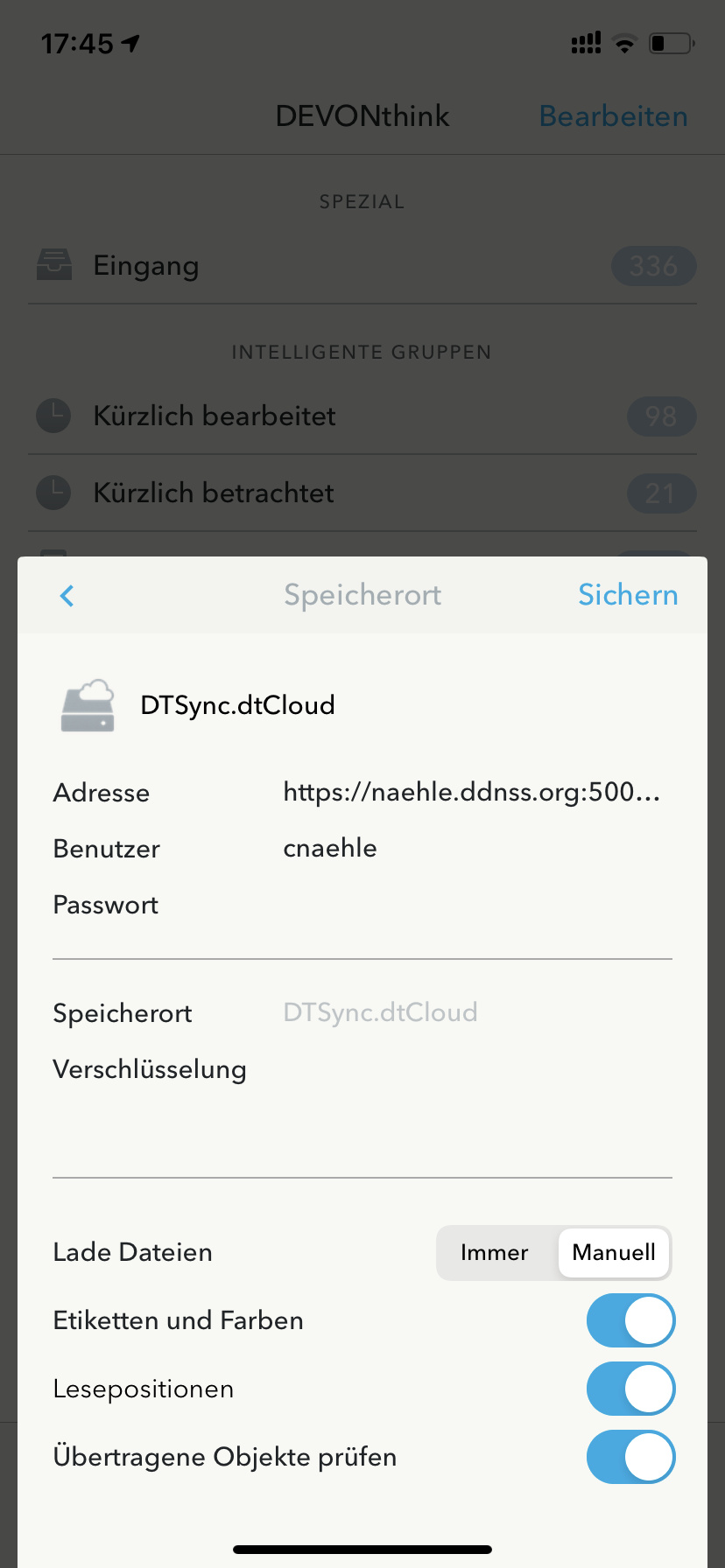

Please select the same sync location on iOS and ensure that the database is enabled. If that’s the case, try to synchronize it.
Sync location is identical
and synching doesn’t really work, I guess - or do I need to perform any specific action on DT3 or DTTG?

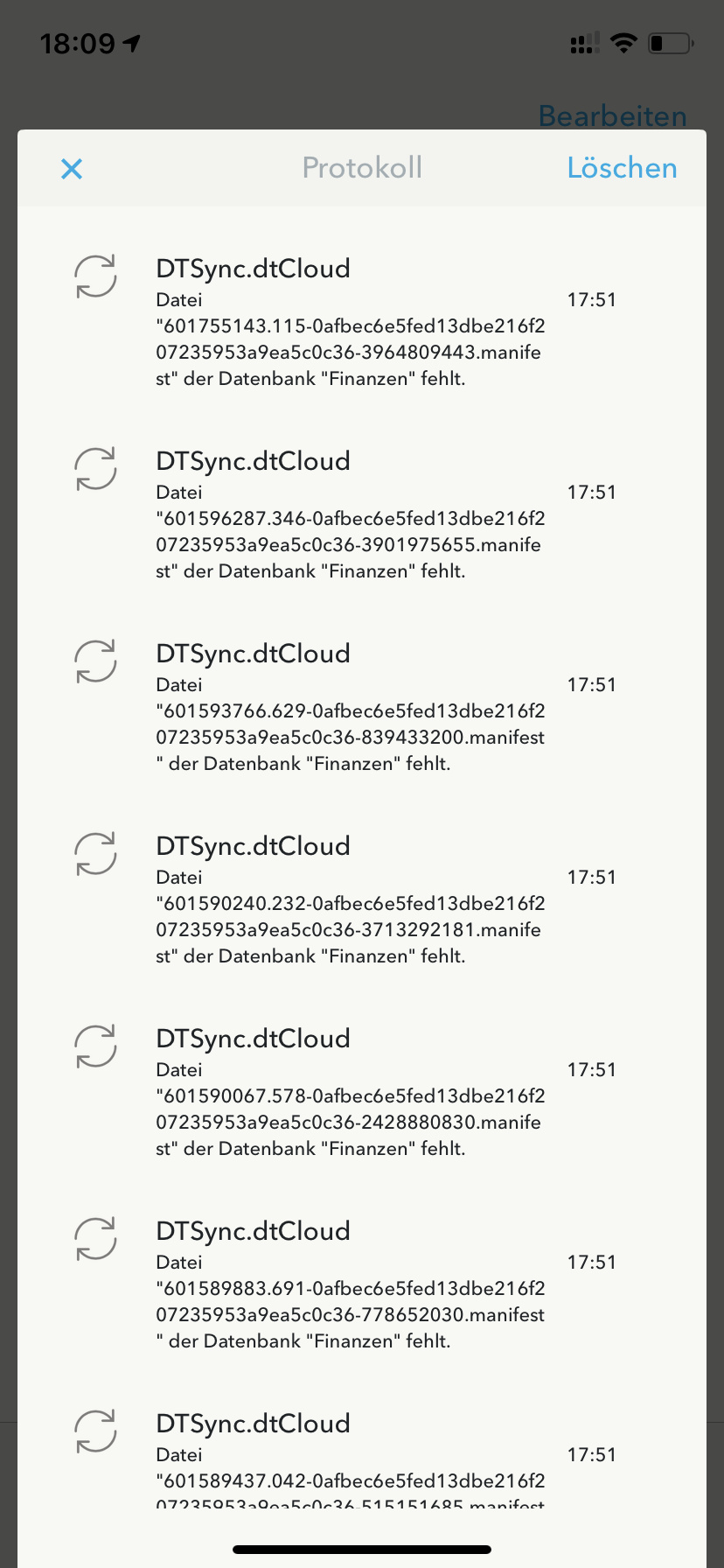

What exactly does not work, e.g. are any issues logged on iOS or on the Mac? Or are the databases not identical to the ones on the Mac?

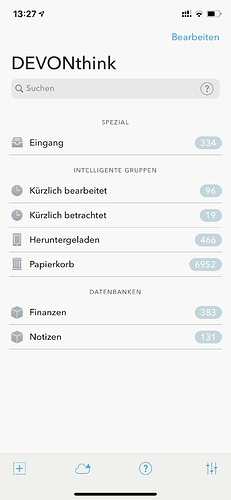

most apparently, the DTTG Eingang is not synched with the Eingang in DT3:
other than that, this is the most apparent issue:
The above procedure was only for the database “Finanzen”, it didn’t change anything related to the inbox. Please delete the log as this might be older entries as the entries include only the time. Are the same errors logged again?
