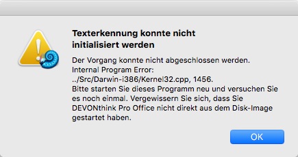

My usual workflow since years is: to scan a document as PDF (with another tool, provided by Canon for the Canon MFP device), then to add it to DT’s inbox, select it manually and invoke manually (via button click) the OCR action. That’s it. This worked for years and just last month (December 2025) I was still using it. Today (in 2026, if that matters) I noticed it doesn’t work anymore and comes up with this modal dialog window:
Brief translation of the main message “OCR could not get initialized”.
I started DT as always, and can exclude the mentioned case as depicted in the hint “dont start it from a disk image”. I have also restarted the application, same result. I did also reboot the whole Mac, and started up DT right after fresh system boot, but still getting the same error message. when trying to invoke OCR.

It seems to be a 32 bit kernel-related file that’s causing the problem. If that suddenly stops working, it is very probable that something has indeed changed. Automatic updates enabled, perhaps?

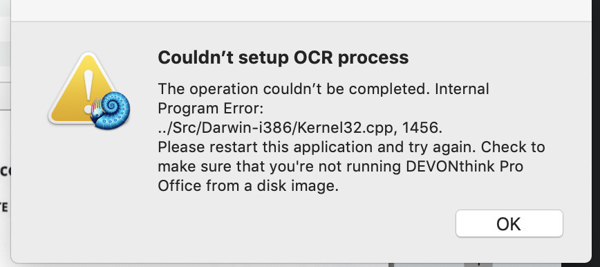

Hi DTUser, the same thing has happened on my Mac system. I’m on the last version of DT Pro Office 2 and on Mac OS 10.14.6. I have been using this software without a glitch since 2014 and now the OCR is not working. I even reinstalled both the software and the ABBYY OCR and no success,
Have you had any success in resolving the issue?
DT do you have a fix?
Nothing has changed on the computer other than the year changing to 2026. It was working fine in December of 2025.

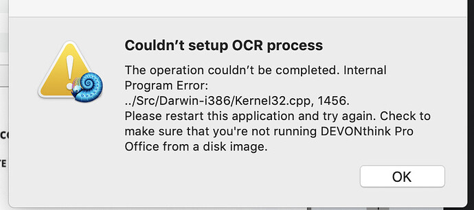

It’s an internal issue of Abbyy’s OCR engine and not controlled by us or our code, therefore we can’t tell for sure. Maybe an issue of a certificate or broken preferences/caches? Did you try a clean, second macOS user account?
I have exactly the same problem, with OCR not working anymore. I get this message:
