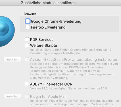

Thank you @tjur for your detailed instructions. I went back to June 10 to find the 1.1.0 version from my Arq backups. I am all set to copy it into my installation but can’t find where to disable the Abbyy extension update. I can only find the pane for install add-ons that shows the extension has already been installed. Where is the control to prevent updates?
Quit DEVONthink and the ABBYY folder. Then do the restore.

Just uncheck the Abbyy extension in install add-ons and click install. Then updates are disabled. Before restoring the OCR helper, quit DT. After restarting DT, you are able to uncheck the update…
