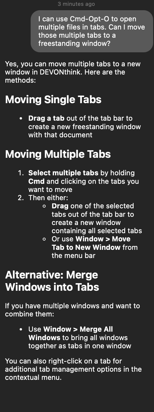

Can I then move those tabs to a separate window? Devonthink Help suggests I can use Window/Move Tab to New Window but I cannot find that option nor can I highlight multiple tabs with Cmd. Is this response hallucinated?
No. It’s only possible to reorder them via drag & drop.

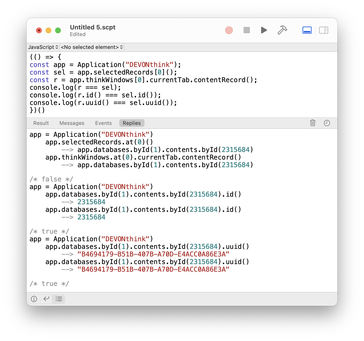

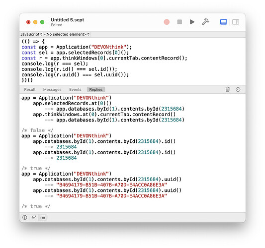

The id property is not intended for public access, I was told. Better use uuid, perhaps.
A window id is also variable.
Is it just that id is not persistent like uuid is, or is there more to it?

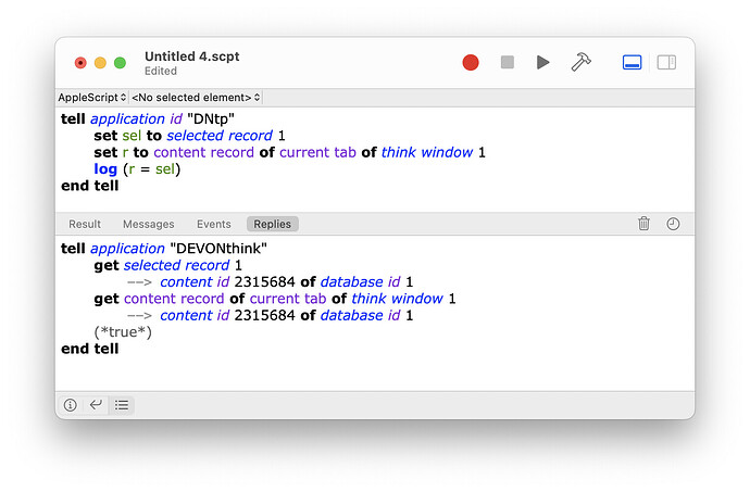

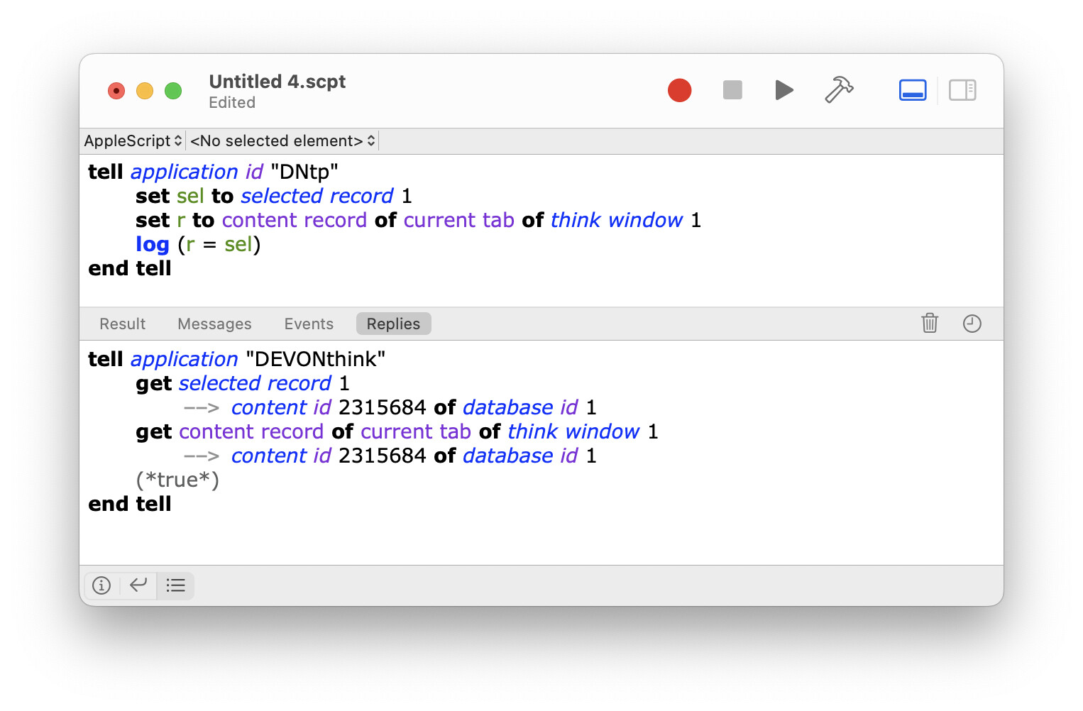

But sure, uuid would fill the same role here. It’s just that comparing two object specifiers that look identical doesn’t work, it always returns false. So you have to compare some property instead, at least from what I can tell. (I guess comparing the string from getDisplayString also works). I just went with id since that’s what I saw in the log.
It does work in AppleScript, however:
A think window doesn’t have a uuid and the id is mutable.
I’m not comparing windows. And I don’t need the id to be persistent in this scenario, I just need the comparison to work.
