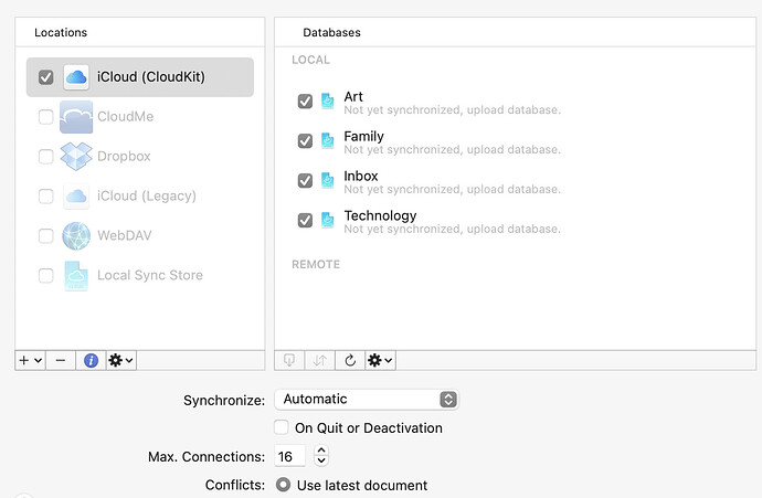

Still trying to sync my DT3 and DT To Go. Using iCloud (CloudKit). In DT3 in sync preferences it’s telling me “not yet synchronized. Upload database.” I tried uploading it to iCloud, but it uploads as a zip file. Is that where I should be uploading it, and, if so, how should I do it so that it’s not a zip file? Thanks.
Uploading the database (which is a OSX “package” of files and not a Zip) is not part of the instructions for setting up a sync. At this point, probably worth going back to the DEVONthink Handbook (or Help, which has same content) and carefully follow the instructions exactly. Also consider doing a Bonjour sync setup first (faster and more reliable, but requires a local network connection).
This is what I’m seeing:
Also, I was under the impression that Bonjour was for machine to machine synching. Is that wrong? Would you use Bonjour to synch between a Mac and an iPhone?
Yes :blush: Fast, reliable, but only available when both devices are on the same network. You can use Bonjour in addition to Cloud syncing if you need/want non-local syncing.
“Upload database” does not mean for you to upload the database in any shape or form; it means that DT needs to do so. Why that is not happening automatically, however, I don’t know. Typically, the upload would start when you select the database; I would expect you to see a wheel rotating next to the name of the database (in the window you posted) showing that the database is being uploaded (the text, however, stays the same until the database is uploaded). Assuming nothing is happening, try restarting the Mac and DT. If that doesn’t help, perhaps try deselecting one database and then reselecting it. Uploading can take some time, especially for large databases.

Thanks for explaining what “upload database” means in this context. Probably would help if the wording were more like “uploading database.”
In any case, I did what you suggested, that is, restarted both the Mac and the iPhone. Didn’t help. Also tried deselecting and reselecting the database (just tried with one rather than all checked at once). Still not working. I hadn’t checked the log as Bluefrog suggested. Here’s what that looks like.
It’s not going to say that since it’s not uploading. It’s telling you what needs to happen.
I don’t remember having created an encryption key. Clearly don’t know the significance of the message.

Then perhaps it ought to say something like “waiting for database to upload.” The user doesn’t know it’s telling him/her “uploading database is what needs to happen.”

Well, I’m not quite sure where that came from, and it doesn’t sit too well with me. However, very much each to their own. If you do decide to set this up so it works, you either need to remember the encryption key you used when you set up the sync store, or set it up the encryption anew; obviously you will need the same key on both devices, otherwise they can’t both sync with the the same sync store.

Even so, the wording is awkward. „Upload“ could equally well be an imperative (please upload the db). „Trying to upload“ might be clearer.

@BLUEFROG Purely from a UI perspective, in this specific case the text should (in my opinion) ideally have changed to “Failed to upload database; see log.” Whilst I personally would not have considered the original text an imperative, and would have noticed the entry in the log, I find it completely reasonable that the OP stumbled over this - to the extent that I cannot actually reasonably argue why I would not have considered “upload database” to be an instruction. I think the fallacy here is to assume that something which is obvious to me must be obvious to somebody else - a catastrophic mistake I have spent a reasonable portion of my life to date making. When making that assumption I have often failed to consider my personal level of knowledge of a subject and the time and effort it took me to acquire that knowledge; in my head, knowledge seamlessly seems to become something “I’ve always known” - and so does everybody else.
