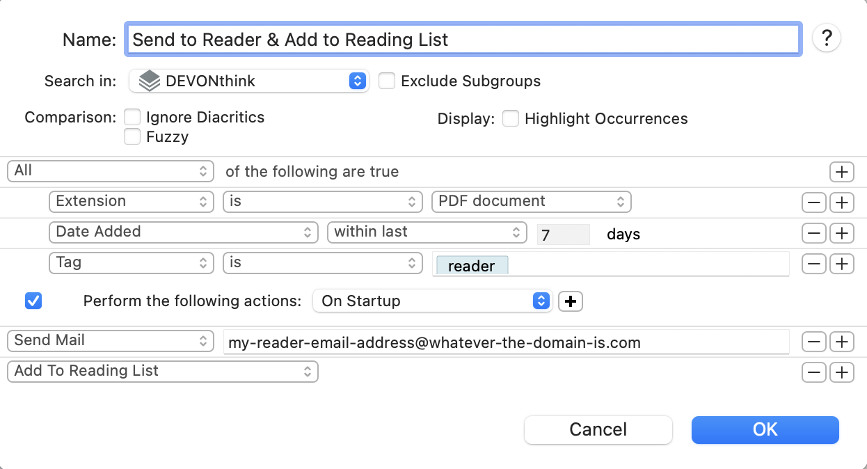

Emailing to an email address on their server which then adds the PDF to my Reading list there. Example: I add a PDF (or epub) to my reading list in DT. A DT rule is fired and the item is emailed to xxxx@library.readwise.io - from there readwise adds to my reading list.
The Reading List isn’t directly scriptable and processing its items involves more processing than may be expected.
Why are you using a reading list to email to another reading list?
I’m not picky how to achieve this. I want to automate sending things to readwise. I don’t need to use the DT Reading List function.
Maybe I’m trying to be too clever. - Mark
As a fellow user who’s also used Reader in conjunction to DEVONthink (but who eventually preferred using DEVONthink by itself), I may be able to help.
It is possible to create a smart rule that can be activated manually to email the PDF and add it to the reading list simultaneously. It is also possible to have this rule run automatically (instead of manually) based on certain triggers (e.g. a tag).
However, as far as I understand, you cannot trigger a smart rule based on an item being added to the Reading List.
As such, the best degree of automation I could think of was a smart rule like the one that follows:
To sum up the rule:
  • If you add the ‘reader’ tag to the PDF;
  • When DEVONthink next starts, the PDF will be a) sent to Reader and b) added to the Reading List.
– Matthew

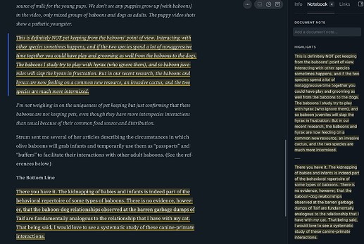

For example, highlighting a markdown document.
In DT, I have to choose between reading and highlighting in the markdown code, or reading the nice-looking preview without being able to highlight.
Whereas In Reader, I can highlight in the nice-looking view. I should be able to do this in DT.
I appreciate that DT is a markdown editor and Readwise is not, but highlights don’t have the same use case as other document edits.
Say I decide to read and highlight in rich text instead, because of the friction reading markdown. Now the issue is that the annotation view is needlessly cluttered by metadata that comes into the import.
By contrast, Readwise understands that I just want to see the highlights.
I can import the highlights from Reader into DT, which is sort of like Summarize Highlights. The DT summary has the useful links back to the document, which I really appreciate. But it brings over the same junk that appears on the sidebar.
The Reader highlights don’t have the useful internal links, but are a lot cleaner and only have the information I want to save–I’d argue only the information that nearly all DT users would want to save.

The next release will most likely revise this and limit the Document > Annotations inspector to annotations/highlights in case of rich text & web documents (e.g. formatted notes) to make this more consistent to Markdown & PDF documents.
By the way, according to the screenshot you seem to be using an older version, the current one is 3.8.7.
That’s good news! Thank you. I swear I took that screenshot on 3.8.7. At any rate, I checked and am on it now. :slight_smile:
