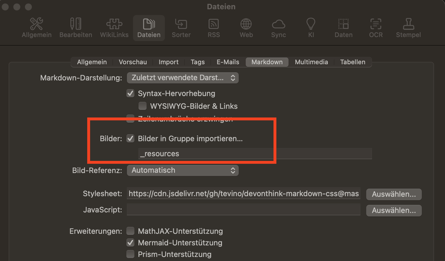

Part of my daily routine is being in consulting calls where I quickly need to make notes and attach screenshots. I did already a configuration that they are put into a _resources sup folder.

I tried already with a Smart Rule, which renames the attachment to give at least the same prefix as the note (which is based on date). But then when I paste the image into the Markdown document, it gets renamed, and the link stays with the original name.
