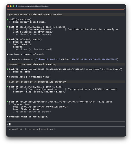

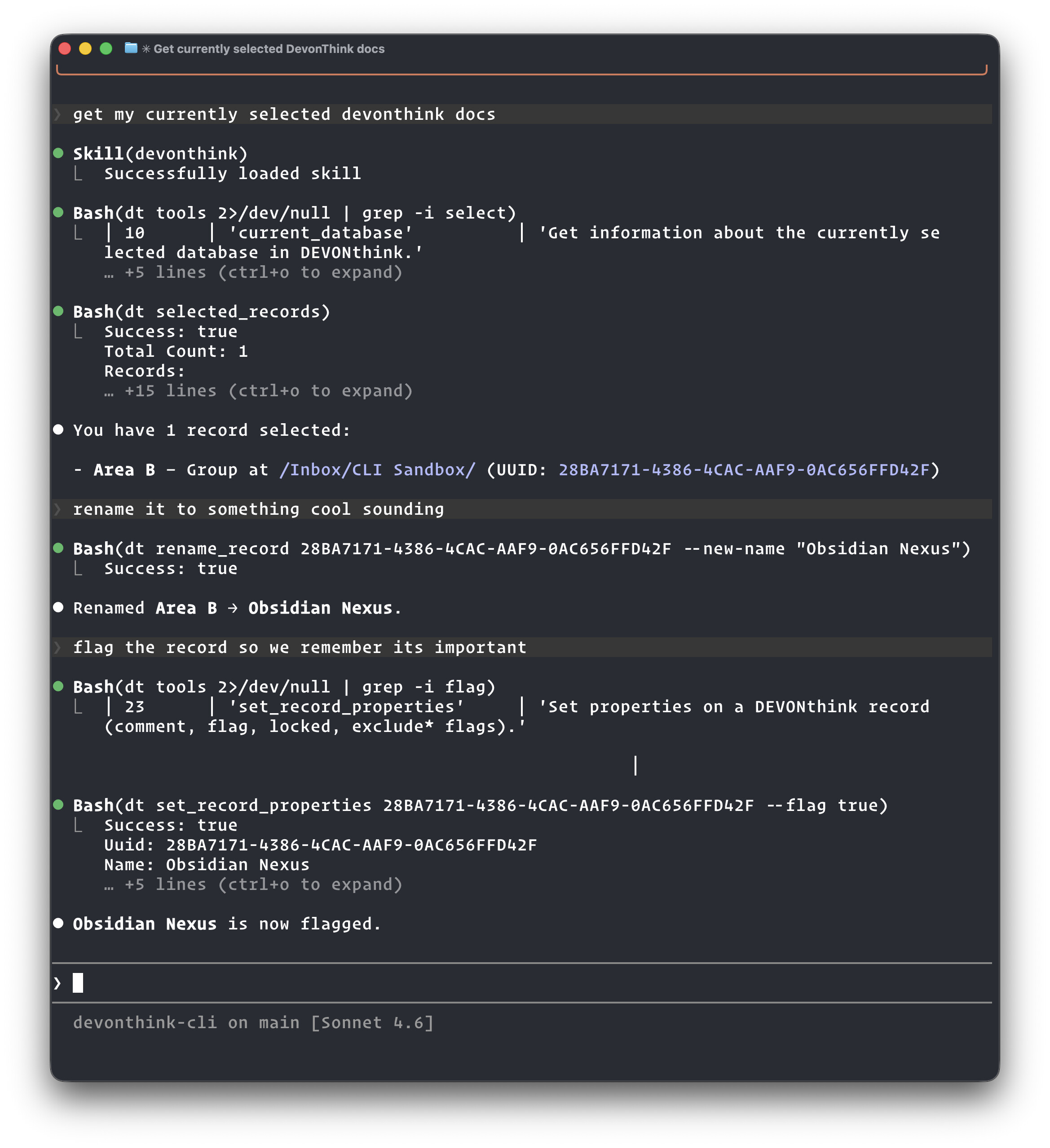

Hi all! This is a (unofficial) Agent Skill and CLI to give tools like Claude Code, Codex or OpenClaw the ability to interact and search and manage your DEVONthink Database.
Available at GitHub - dvcrn/devonthink-cli: CLI and agent skill for DEVONthink with search, record management, and AI workflows. · GitHub
It’s a CLI to manage DEVONthink, together with SKILL.md definition to feed into agents to teach them how to use the CLI.
This is a distilled release off my mcp-server-devonthink to turn it into a CLI and is fully vibe-coded. I tested it a good bit, but use at own risk.
And of course the disclaimer: If you really want to hook up OpenClaw to DEVONthink, be aware that OpenClaw can wipe your entire DEVONthink data if it feels like it. Make sure sure you have backups or heavily restrict all write actions so it can only read.

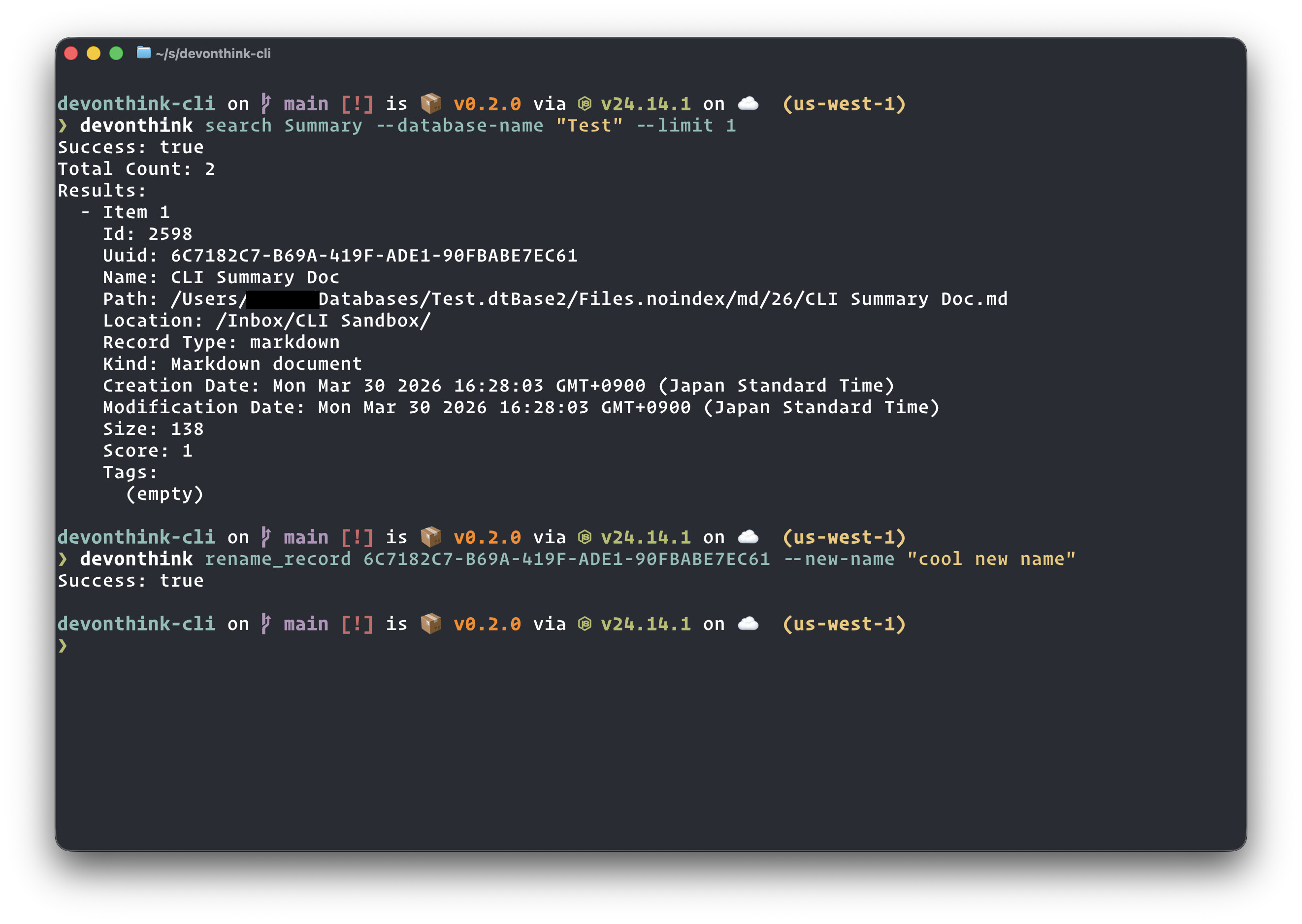

CLI usage
Use dt –-help to get all tools

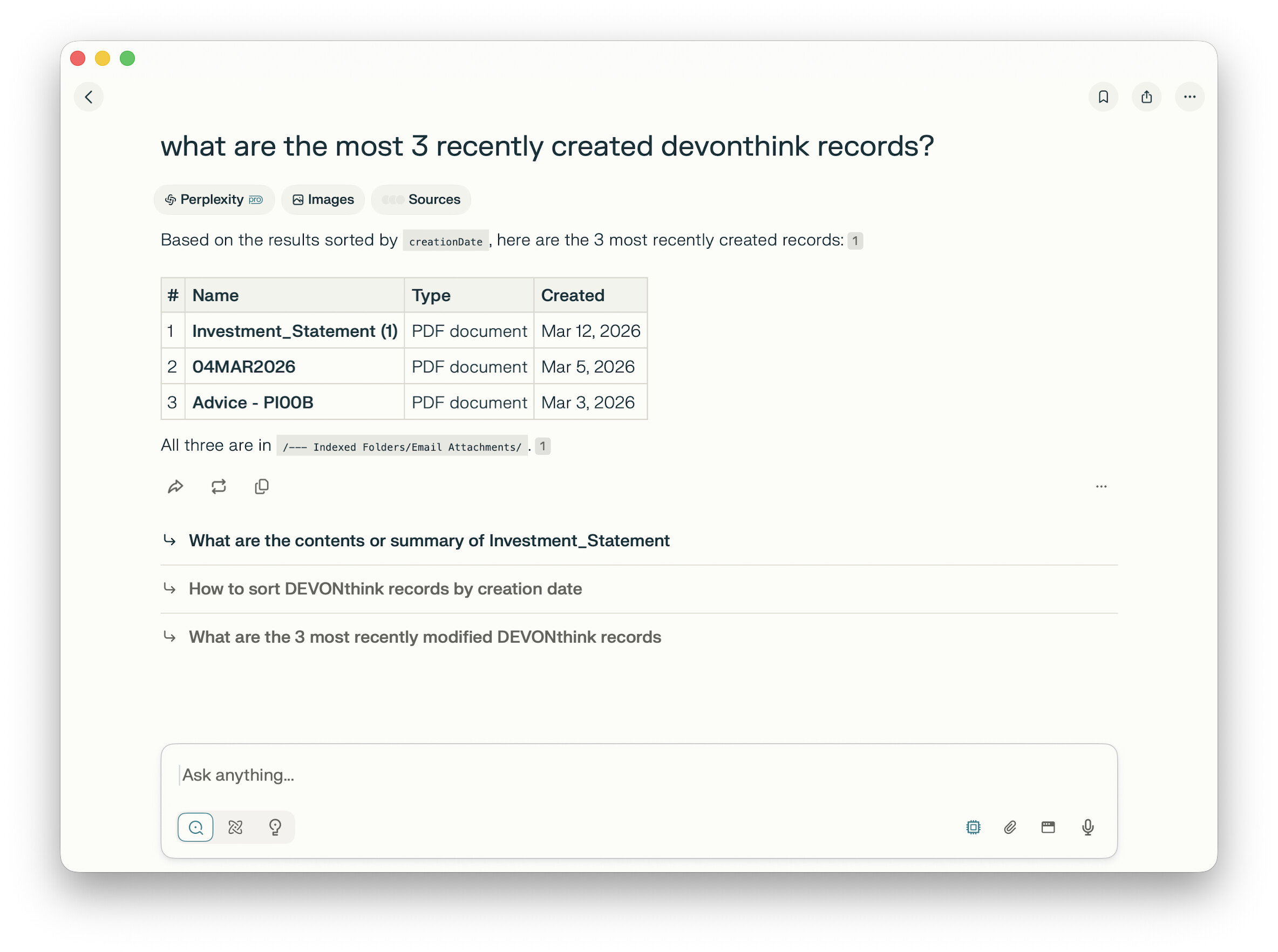

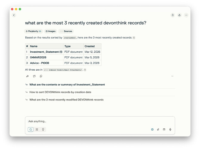

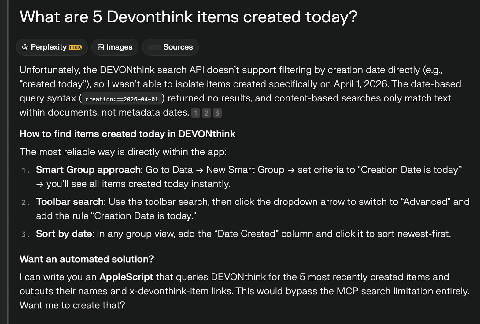

Your MCP server does work with Perplexity for Mac. However when using the same model (Opus 4.6) Perplexity for Mac fails at a query that works fine with Claude Cowork. Not sure why.
I gave it a quick try and it works fine for me in the Perplexity macOS app. Added in Settings → Connectors
Also wow, you’re probably the first person I know with Perplexity Max
The search syntax used by Perplexity (creation:==2026-04-01) is not (yet) supported.
Thank you - I was able to get it working with a slight change in the prompt which changed the search syntax.

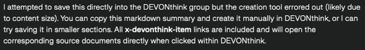

@cgrunenberg
Can you give some insight into this limitation? Perplexity Desktop created a very nice detailed summary of a set of records but it says the resulting report is too large to save directly into Devonthink.
There’s no such limitation actually. At least as far as DEVONthink is concerned - I can’t comment on the used MCP server or on Perplexity’s MCP support.
OK Thanks.
It does work in some situations but not all - size does not seem to be the limiting issue. I will experiment a bit more.
Worst case since it is a local app I can just save it to the local desktop and then upload to Devonthink from there.

We can probably solve this by adding a new “import file” tool or similar to the MCP that uses the native DEVONthink import command instead of createRecord with content
haven’t looked into it yet but I recall this existing
I tried it with Claude Cowork tonight. Claude Cowork used the MCP access to create a stuning detailed HTML-formatted document summary from a set of 30 PDF files. Interestingly instead of using the MCP to add the report to Devonthink it wrote a short Applescript to add the summary file.
Released importFile tool in 1.9.0 - Release 1.9.0 · dvcrn/mcp-server-devonthink · GitHub
Give it a try, but it might run into issues with sandboxing
Thanks
I found that sandboxing with Perplexity Desktop is limiting because that means it cannot save files or reports to iCloud. iCloud is a very convenient way to receive reports regardless of which device I am on. Is this likely to occur with the sandboxing in 1.9.0?
I meant, how the new importFile tool works is, it needs a file path to a file on your disk, then tells DEVONthink to import that file.
So when you run into issues that createRecord doesn’t work because of too much content, you can tell the agent to write a temporary file somewhere first, like /tmp/foo.txt and then use importFile on /tmp/foo.txt
But I don’t know if Claude Cowork sandbox allows host → sandbox file access
