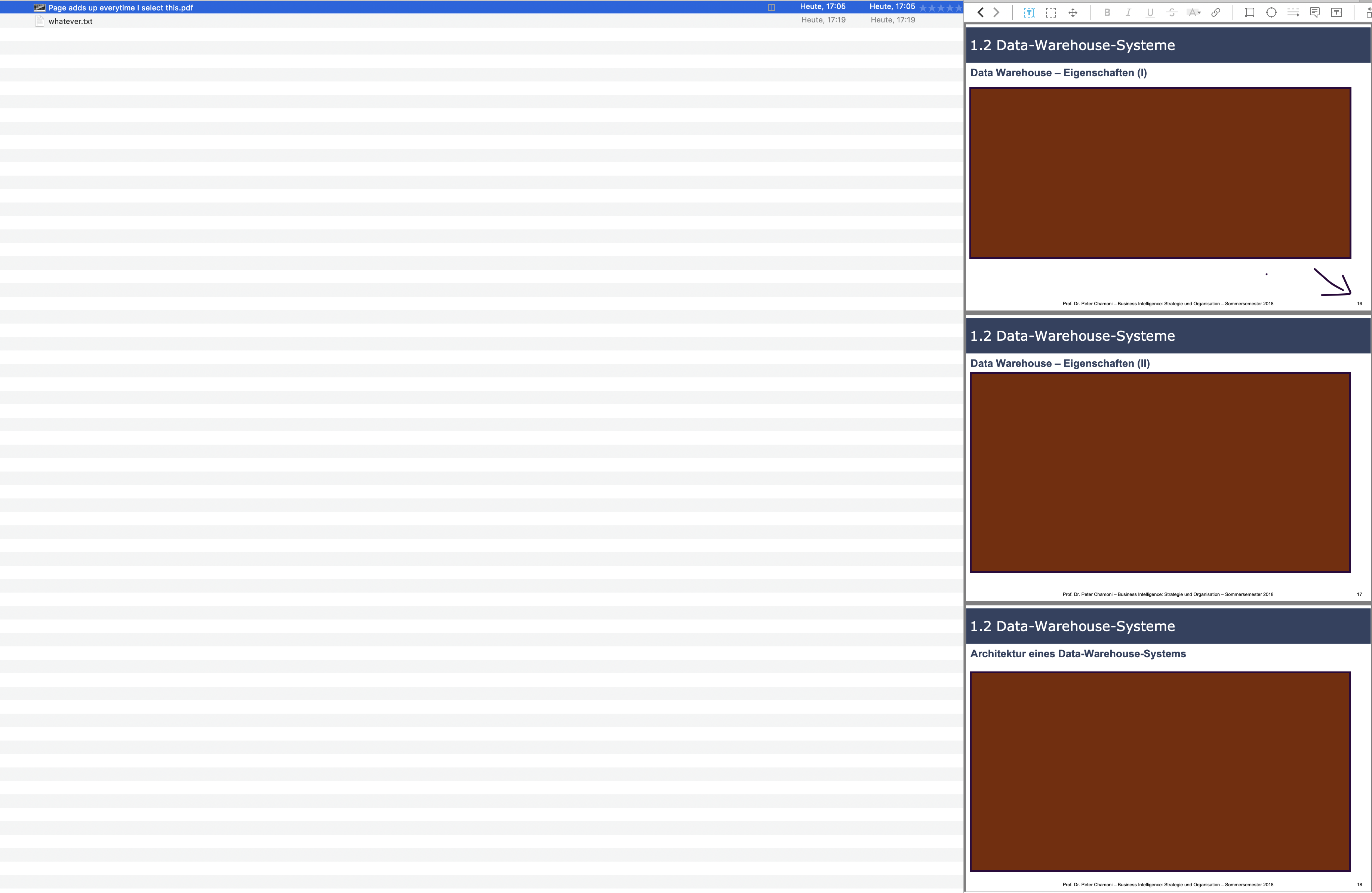

voilà
So PDF A is on page 1.
You select PDF B.
You switch back to PDF A and it’s now on page 2?
I have confirmed this but only using the same configuration as you, which is definitely unusual.
Do you usually compress the view/edit like this? If so, I’m curious why.
@cgrunenberg it happens if you compress the view/edit pane until there areat least three pages in the PDF showing, even if that’s only a small amount of the third page, like so…
