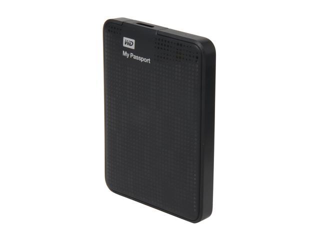

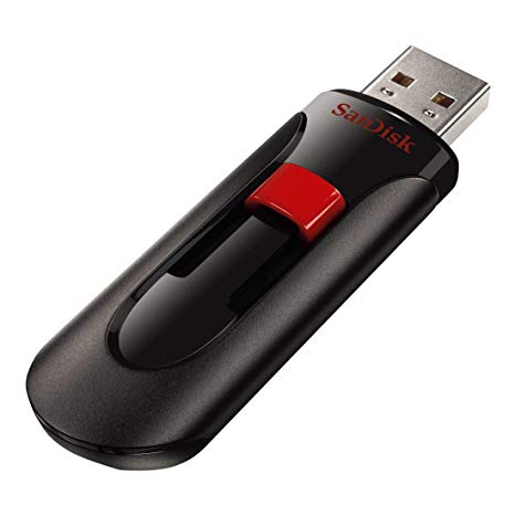

On a side note - outside supporting Criss’ comments about sync not being a primary backup - I would suggest an external drive over a flash drive, i.e., an external SSD / spinning drive over a thumb drive.
For some reason, because I had Dropbox, I assumed I should use it
Absolutely! And I have told people this for years: Use a remote sync solution if you need it. Just having a cloud account does not make it optimal.
I could haul construction materials in my Mazda 6, but that certainly doesn’t make it an optimal vehicle for such activity. :slight_smile:
Very helpful! Could you explain why the spinning disk is better? I am using a Sandisk 500 GB Extreme Portable SSD connected by USB 3, and it seems to work very well and is pretty small…
Ahh… No, the spinning disk isn’t necessarily better. Just an external drive, whether SSD or spinning disk, will be more robust over the long term than a small flash drive.
22-236-191-08
is better than…
SX466
OK, thanks! My investment in Sandisk is secure!
