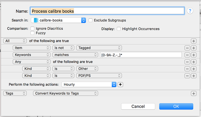

I just want to kick off the procedure Convert Keywords to Tags for a fixed group from an external script.
Background:
I have an external (Python) script that replaces some documents in ~/Dropbox/read/calibre-books nightly. This folderis indexed by DT3.
So at the end of the external script I would like to instruct the running DT to:
- Re-index the DT group pointing to
~/Dropbox/read/calibre-books. - Kick off the Convert Keywords to Tags action for this group.

To “close” this topic, with the new SmartRule feature in DEVONthink 3.5 I could solve this issue (with the generous help of BLUEFROG) very elegantly:
