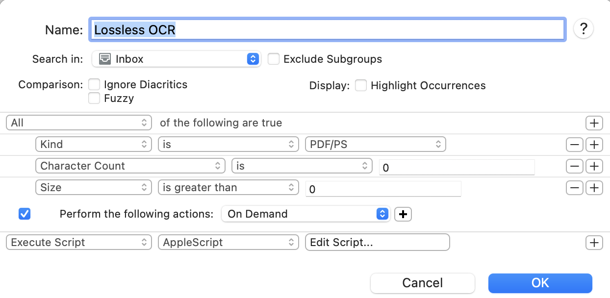

This workflow works great whether I scan documents with my phone or download PDFs needing OCR on my Mac. However, I already have loads of PDFs inside DT that still needs OCR.
So I spent some time (despite it just being some minor tweaks that were needed) getting it to work in DT as a Smart Rule:
The updated AppleScript used for the Smart Rule is this:

Figured I’d share it here in case others find it helpful.
Note: I’m an AppleScript novice, so if there’s anything that could be improved upon, please let me know!
