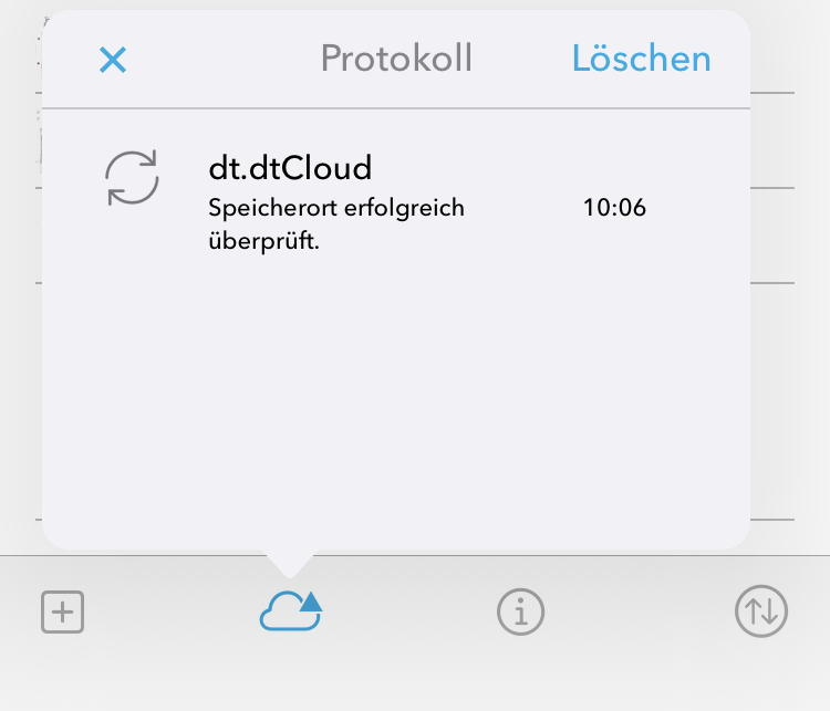

Is anything logged in the log in DT or DTTG? What kind of data is missing? In the sync settings in DTTG on the iPad, is the last sync shown to be recent, or is sync maybe not working at all?
How do I see the DTTG protocol? According to the settings everything is synchronized.
Some pdf files missing in my base.

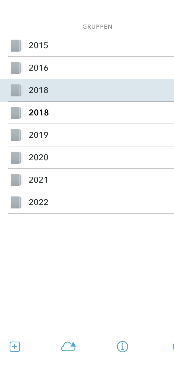

Simply tap the cloud symbol in the bar at the bottom (if it has no triangle symbol superimposed, then the log does not contain any warnings).

yes synchronize multiple databases. One private and one for work. The private one is complete. Within the work database data is missing, i.e. not visible. On my iPhone or Mac I see the data completely. I also noticed that some data is displayed twice.
There should be 12-15 pdfs in each folder. The 2017 folder is not synchronized at all. But 2018 is displayed 2 times.

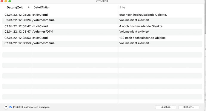

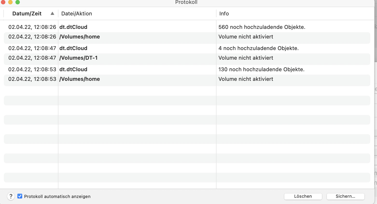

I don’t see where you responded about anything logged in DEVONthink’s Window > Log.

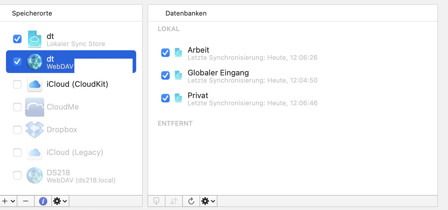

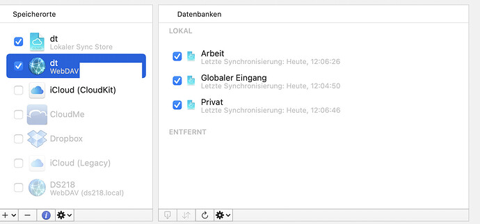

Please post a screen capture of DEVONthink’s Preferences > Sync with the sync location selected.

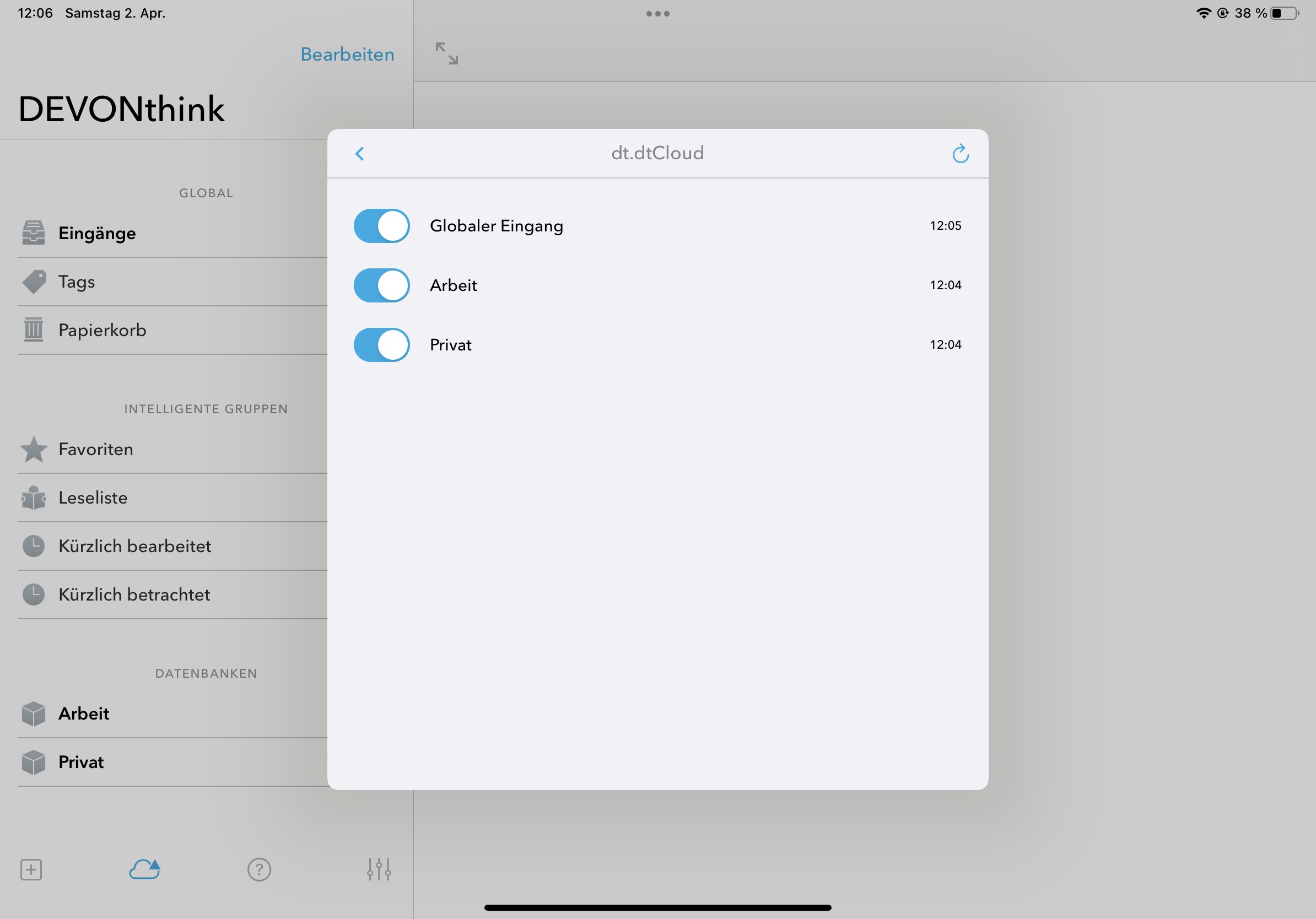

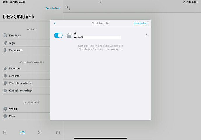

Also, go into DEVONthink To Go’s Settings > Sync: Locations, tap the sync location, and post a screen capture of the Databases list.
I tried it, unfortunately no improvement.
The last screenshot seems to indicate a missing location. Also, I’m wondering about the “volume not mounted” messages in the log. Did you store DT data on external hard disks or network volumes?
Yes, my data is stored on a network server. The log error is since the update to 3.8.3 see article Help: Irritating Log Message
Your Log window is showing the home and DT-1 volumes aren’t mounted.
I’m guessing one or the other is necessary in the situation. Please clarify.
PS: If you are putting your DEVONthink databases on an NAS, we don’t suggest this unless you are on a gigabit Ethernet connection.
It is mountend. I see the path in my finder
And you can access its content, too?
