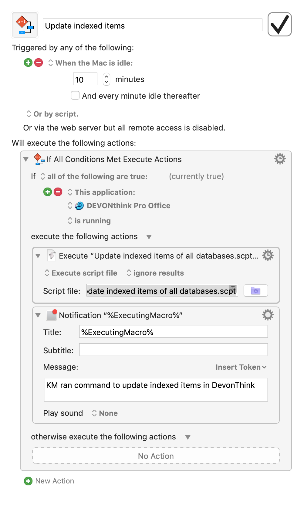

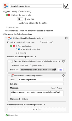

I use Keyboard Maestro to launch the following DTPO Apple Script when it detects my Mac has been idle for 10 minutes and DTPO is running. This keeps my three databases updated that index various folders from OneDrive, Dropbox, and Box.
~/Library/Application Support/DEVONthink Pro 2/Scripts/Data/Update indexed items of all databases.scpt
Thank you very much – this fits perfectly.
I already use Keyboard Maestro for just about everything, so it would have been part of the solution anyway. My difficulty was working out how to update the indexed files using DTPO. I looked for an existing script in the script folder under ‘Index’ and didn’t see anything, so I tried to write my own and got nowhere. Didn’t think to look under ‘Data’…
So, all done and tested – many thanks again!

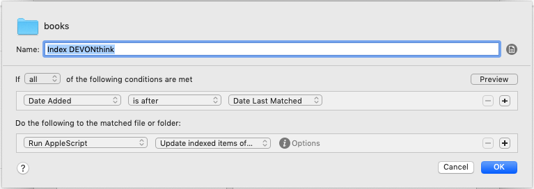

This was a very helpful tip, thanks! Here’s a screenshot of my Hazel rule that does what you described. It just runs the Update indexed items of all databases.scpt script that available via Help -> Support Assistant -> Install Extras -> Update indexed items script, which shows up in ~/Library/Application Support/DEVONthink Pro 2/Scripts/Data as mentioned elsewhere.
