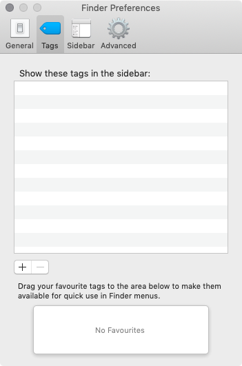

You can do a multi-delete from Finder Prefs and select a range to delete. I accidentally deleted the default ones too on second attempt, so just went Command-A the third time.

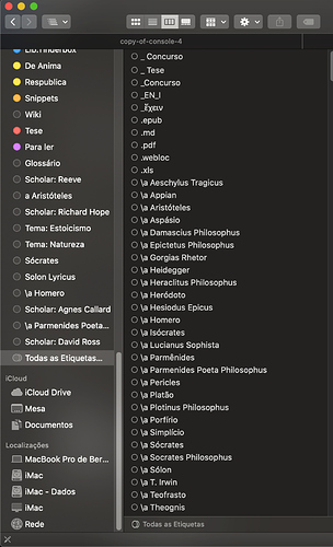

Thanks for the tip. The problem with this approach is that you would need all the tags to appear in that window, but they don’t. Most of them will appear only when you select all tags in Finder
