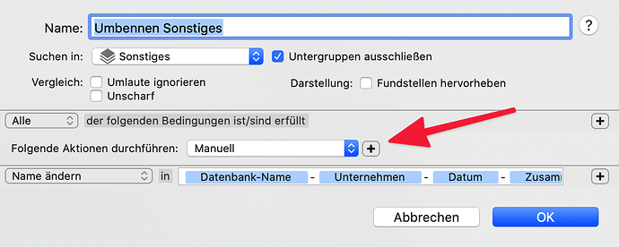

Furthermore, I don’t understand how this renaming job could be active, because I explicitly excluded subgroups.
Nevertheless, both subfolders and files are renamed. (Name of the Folder should be “2010”.
CleanShot 2020-09-15 at 22.26.37@2x
To explain again briefly what I have done: I moved a folder to “Legacy” from the Finder. Then I would have expected that the smart-rule would not be active because it is a subgroup.
I checked all other smartrules as well, but they are also restricted to a certain database and always without subgroups. If i remove this filter everything work as expected. What am I doing wrong? or a bug?

Could you pls post your smart rule without the drop-down? I’m currently at a loss to explain why the smart rule triggered - and would like to play with an identical smart rule. What’s your “Suchen in”? i.e. was it (the root of) a database, or a group? Are you using the most current version of DT?

  • You don’t have any criteria specified. Why not?
  • Excluding subgroups does not mean to not act on groups. It means ignore the contents of subgroups from being processed.
I wondered about that; but if I understand the OP correctly, he dragged a folder called “2010” from the Finder to a group called Legacy. I would have expected “2010” to be acted on by the smart rule (as it was, becoming “Sonstiges—”), but I don’t think I would have expected the contents of “2010” to have been acted upon (unless using DT3 prior to DT3.0.4, in which case depending on the search location, I might have expected it, but I’m not really sure…)
As the OP has no criteria specified in the smart rule, is that smart rule even responsible for what has happened? My experience is that the rules don’t act if no criteria are defined.

Current status:
Status before switching to manual:
i use 3.5.2 of devonthink.
That was exactly what I expected. Folders yes, but the content (files) is not touched. But in my example the file is renamed. :frowning:
Currently none. I also thought that I could exclude cross defects with other filters, because the problem was solved after I switched this filter to manual.
