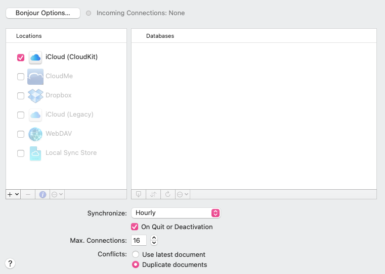

Since I moved to DT4, I changed the sync interval (CloudKit) to run hourly due to the sync running constantly and the database icons flickering as a result (discussed in the forum here). I thought this had addressed the problem, but this morning I was updating a rich text document and every time I made an amend, the little log window would pop up to say “uploading to CloudKit”. It would run without issue and then disappear. It’s likely it’s been doing this since I changed my sync interval, and I simply hadn’t noticed until this morning when I had no windows open except the document I was working on.
To me, this isn’t expected behaviour, as I’ve told DT to only sync once an hour (and also it feels sensible that the upload only goes to CloudKit once the document is closed perhaps, not every time I make an amend). My DTTG only download on demand and were not open at the time.
I’m unsure whether I was meant to change some settings on my DTTG devices at the same time as updating the sync interval on my Mac, and whether this is causing the issue. My queries are:

A screenshot of Settings > Sync would be useful, thanks.
Sorry, I wondered and assumed it wouldn’t tell you much!

Switching to another app is a deactivation.
Thanks for your help with this, Christian. To summarise, “deactivation” basically means DT isn’t the main/active window on Mac. So ticking the “On quit or deactivation” box for sync means that DT syncs every time you navigate away from DT.
This seems like sensible behaviour and does mean DT is working the way it’s been told to work (Yey! Good news for you!).
