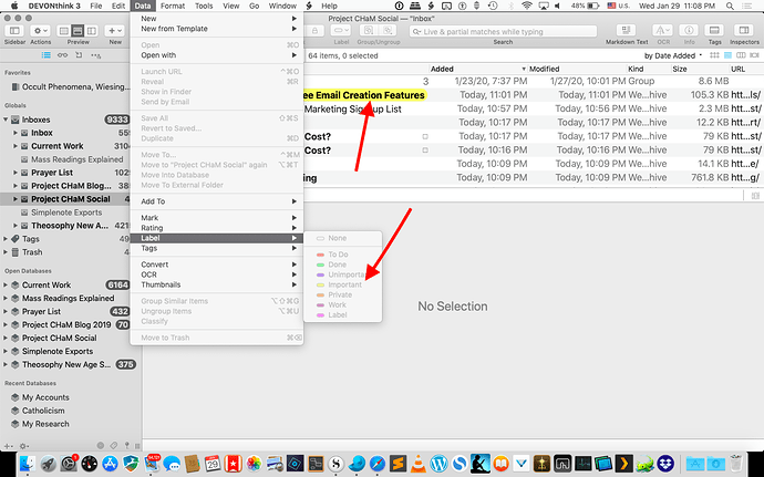

Hi all,
So it seems that I can’t use labels for groups --> same problem as original poster. This screenshot shows that once upon a time (i.e. DTPro Office 2) I was able to do this. A group is selected, but from the drop-down menu the labels are unavailable. You can see that other (older) groups have colour labels.
Can we have colours back for groups? Is this a consequence of groups being tags/tags being groups?
Tineke
This is currently only possible after selecting the group in the main view.
Oh ok… that’s weird (from a user standpoint), but it works.
Wish list item for a future update, please! Ta!
