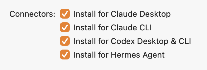

DEVONthink is looking for a local installation, possibly a ~/.hermes directory, though @cgrunenberg would have to confirm or deny that. Once I did a local install, I had the option enabled…
BLUEFROG:
Only local installations are automatically detected and supported. In all other cases a manual configuration is required. See e.g. DEVONthink MCP with BoltAI2

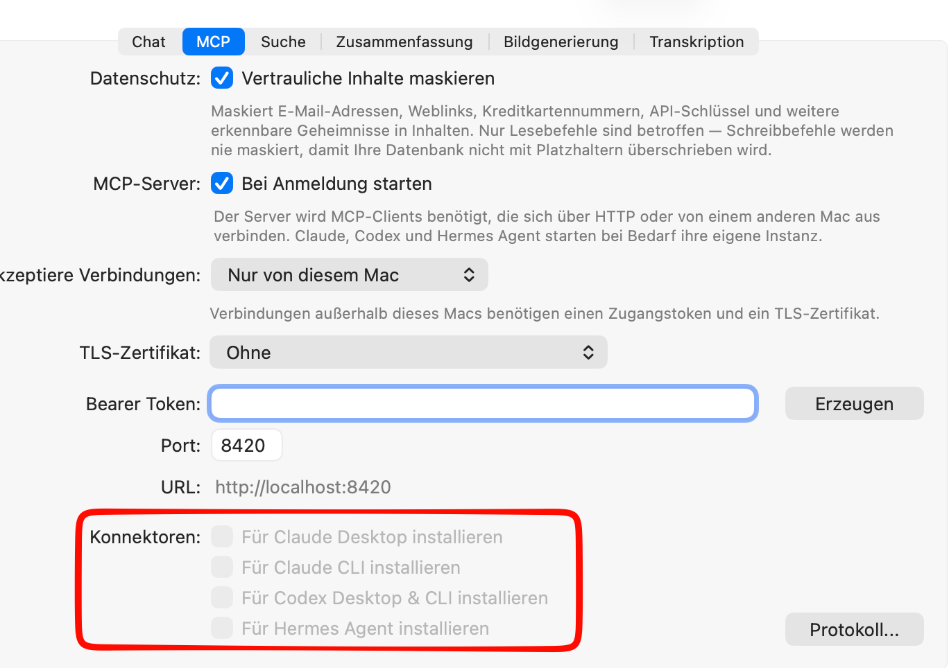

I tried it. But hermes could noct connect to my local MCP-Server. The reason is probably in the settings:
accept connections: from my Mac only
It’s not changeable to accept connection from my LAN.

Connections from the local host are not accepted either. Very irritating.
One of the hints in Devonthink: “Connections made from outside this Mac require an access token and a TLS certificate.”
But how am I supposed to import a certificate? That sounds rather complicated, especially as I can only use LE certificates at best.
Connecting from another device generally does require acquiring, installing, and trusting a proper TLS certificate. Self-signed certificates will not work. However, getting one is beyond the scope of our support. There is no one method of doing it and yes, it can be more complex than people may imagine (and not necessarily free) .
