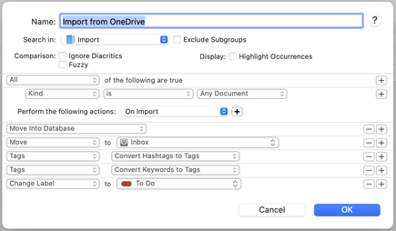

Thanks for your reply. It seems very interesting. So instead of sharing your scans (through DTTG or Airdrop/Finder) you sync them with the help of One Drive, if I understand well. But it’s a bit complicated for me how you do this exactly. Could you please explain what this means: ‘I’ve indexed that folder in a DT database’. Does it mean that you can have a One Drive (or a Dropbox, iCloud) folder visible in your DT-sidebar? I wasn’t aware of that possibility.
The automatic OCR’ing is another interesting feature. Is it possible to share the smart rule you operates on your folder? I use DT3 on a daily basis, but I’m unfortunately not very good with the more complicated features :slight_smile: Thanks @rpallred !
An indexed folder must be part of a database, so at first pick a database you want it to belong to. If all the PDFs go to one database presumably that would be the one. Could be the Global Inbox too.
Select the database in the DEVONthink side bar and then go to Files/Index Files and Folders…. When you have access to One Drive via the Finder you can chose the folder your scanning Software saves the PDFs to. And that’s it. Then you can see the content of that folder in DT. And of course you can, either manually or by Smart Rule, process it.
I mis-remembered: I have two different folders with corresponding smart rules. iPhone apps that do their own OCR save to an import folder, other apps save to an OCR and import folder:
Screen Shot 2022-01-04 at 8.48.23 AM
Screen Shot 2022-01-04 at 8.51.11 AM
What I did was create a database just for these folders that is only open on my server instance of DT (e.g., I don’t sync it with DTTG or the MBP).
Screen Shot 2022-01-04 at 8.53.32 AM
And it all just works! Magically. Thanks @rpallred and @suavito
