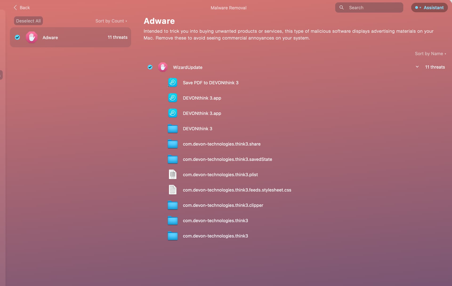

And just in case anyone’s interested in a little history…
This was a situation where DEVONthink itself was registered as malware. It was rectified but another reason we recommend abstinence or caution. Take your pick :slight_smile:
