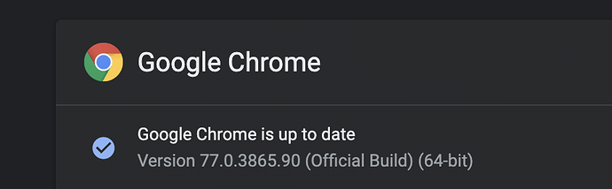

Do both Macs use the same versions of macOS and Chrome? It’s possible that this is intentional and that Chrome uses now the same annoying alerts as Safari.
Same version of macOS and Chrome on both
There is some difference between the two of them in security settings (as discussed here Security Issue with Reminders Script ) but that was a while ago and this change in behavior with the Chrome extension just started yesterday.
Did a new version of Chrome install maybe last night? Which version of Chrome do you use?
I do not know if there was a new version that was just installed but the versions match on both of my computers so I remain puzzled why the problem is only on one of them.

I’ve just checked with the very same version. Works as expected. So, in short, there must be some security setting that is different. Browsers add more and more security mechanisms that may or may not interfere with extensions such as Clip to DEVONthink (or remove them altogether, like Safari).
