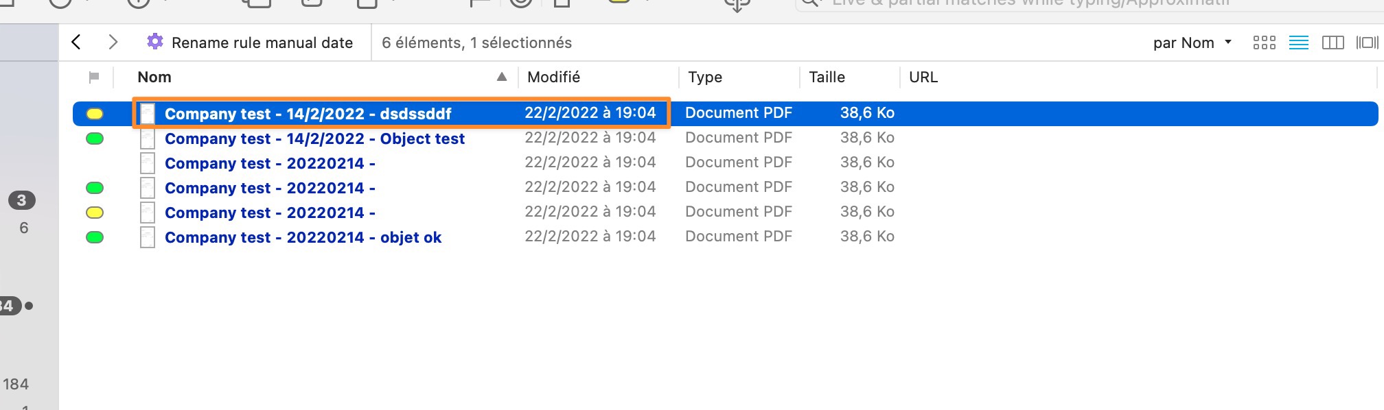

Before adapt my code to use “date_metadata” I would like to concatenate 2 simple metadata, but actually the code does work :

I probably need to define some rules to trigger the smart rule : if the 3 metadata exist then rename the file and put a green flag.

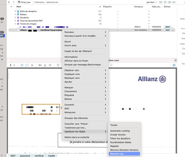

What I see is right clic on a file and select the rule does not trigger the smart rule. D’n’d with on the smart rule trigger it

In fact Tools > Apply Rule does not work. Same for right click. Does not work either.
