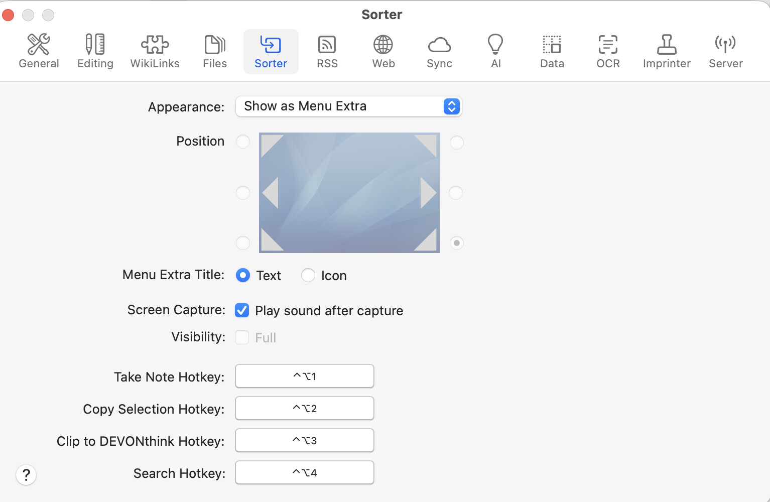

Yes, it is annoying. On my machine sometimes the Safari extension works and sometimes it doesn’t. But the Sorter always works. Here are my settings for the Sorter. (Instead of clicking Save when the Sorter appears, press CMD-S :slight_smile: ) When your muscle memory becomes strong enough you can set Appearance as None if you like.

@cgrunenberg directed me to this solution. The Show as Menu Extra gives you a way to access the sorter via the menu bar at the top of the screen. Show as Dock Tab is another way to access the sorter. I have grown used to my hotkey combination so I don’t need the menu extra or dock tab anymore :blush: This set up works great for me and it’s great to hear that it seems to work for you as well.

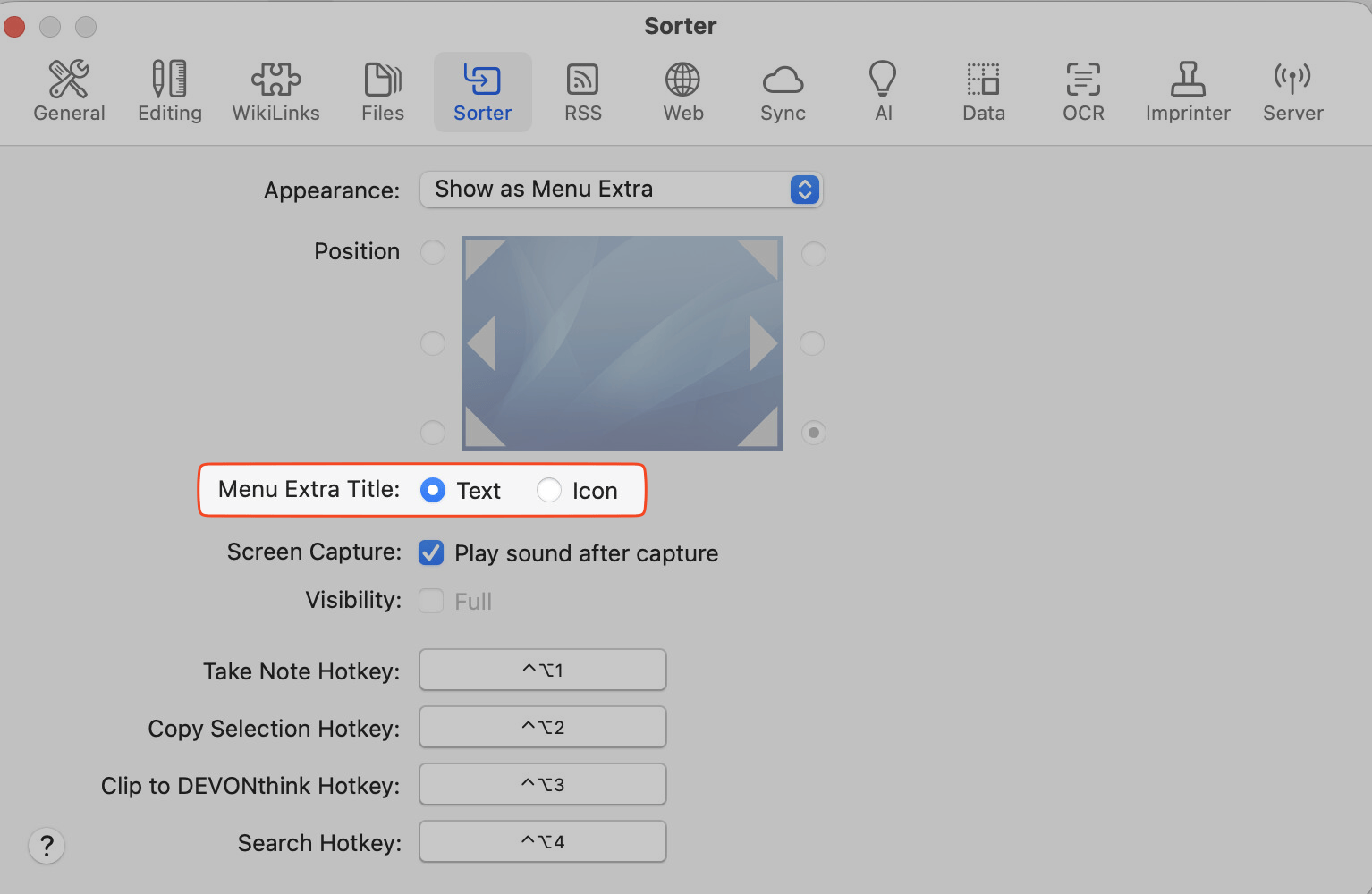

Is there a way to replace the word “DEVONthink” in the menubar with the DEVONthink icon. Space in the menubar is limited.
Thanks.
See Settings > Sorter > Menu Extra Title
