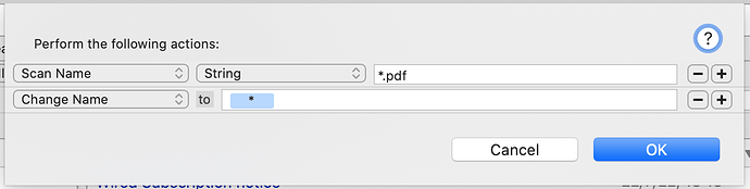

I started with the Batch process actions from Bluefrog’s post (using the * placeholder):

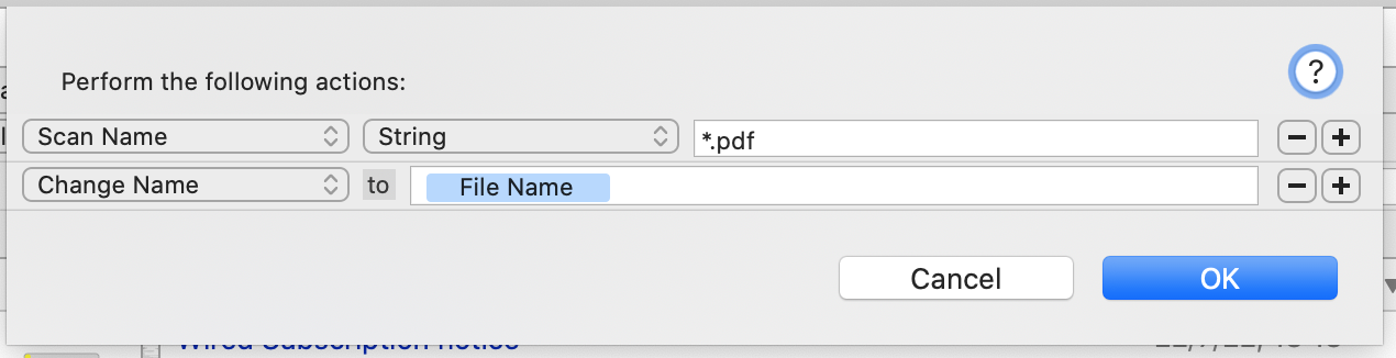

But somehow this does nothing (neither to the name nor to the underlying file). Then I tried using the File Name placeholder:
This does change the underlying file to one extension:
DT Extension Cleanup_Screen Shot 2022-09-02 at 12.44.26

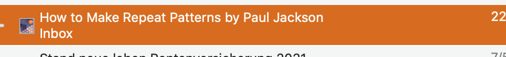

So far so good - but it adds to the document name the extension as well:
So my question is: How can I add now some action to the Batch process, so that the document name changes to no extension? (And the filename still has one extension.)

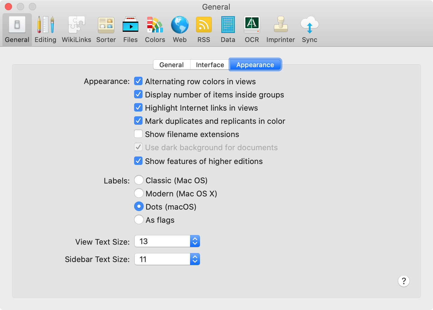

If you don’t want to see them in the item list, have you disabled Preferences > General > Appearance > Show filename extensions?
Yes, Show filename extensions is unchecked:
