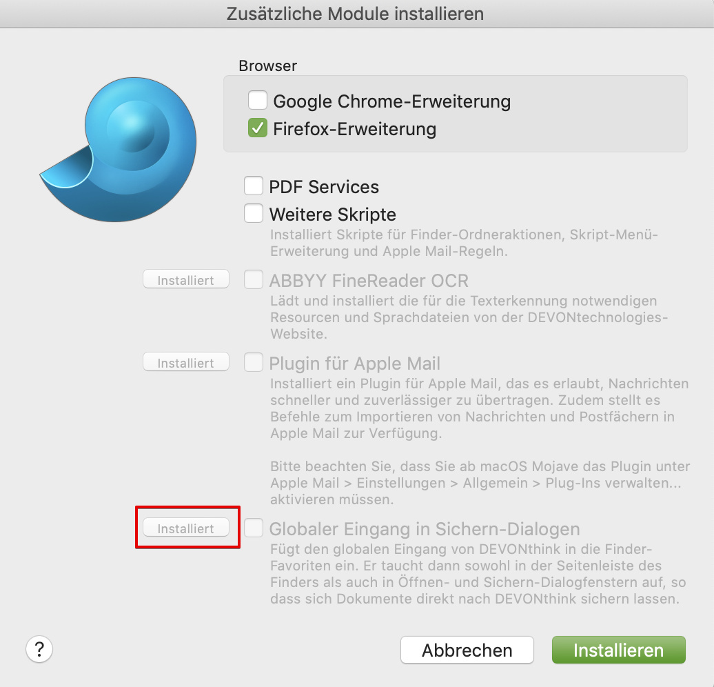

I have the same problem. There are two solution which both do not work for me.
(1) I cannot install the modules, they are installed, greyed out in the dialogue window.
The OCR works, but I do not see the Mail PlugIN which I do not care about at the moments.(2) I tried to drag the INBOX for Devonthink 3 into the sidebar, it looks as if I can place it there, but when I release the mouse button, the INBOX does not appear in the side bar.
I am working on Mojave, actual version.
The INBOX in the sidebar is very much needed!
The plugin has to be enabled in Apple Mail > Preferences > General > Manage Plugins…
The inbox folder (not database) can be added to the Finder’s sidebar, just drag & drop ~/Library/Application Support/DEVONthink 3/Inbox to it.

I expected the Inbox to have this special “DEVONthink inbox” look, and never found it. Now that I took the screenshot, I saw this absolutely “NORMAL” inbox, and after opening it, it had the “DEVONthink inbox” look in the window top bar and – it is it!
