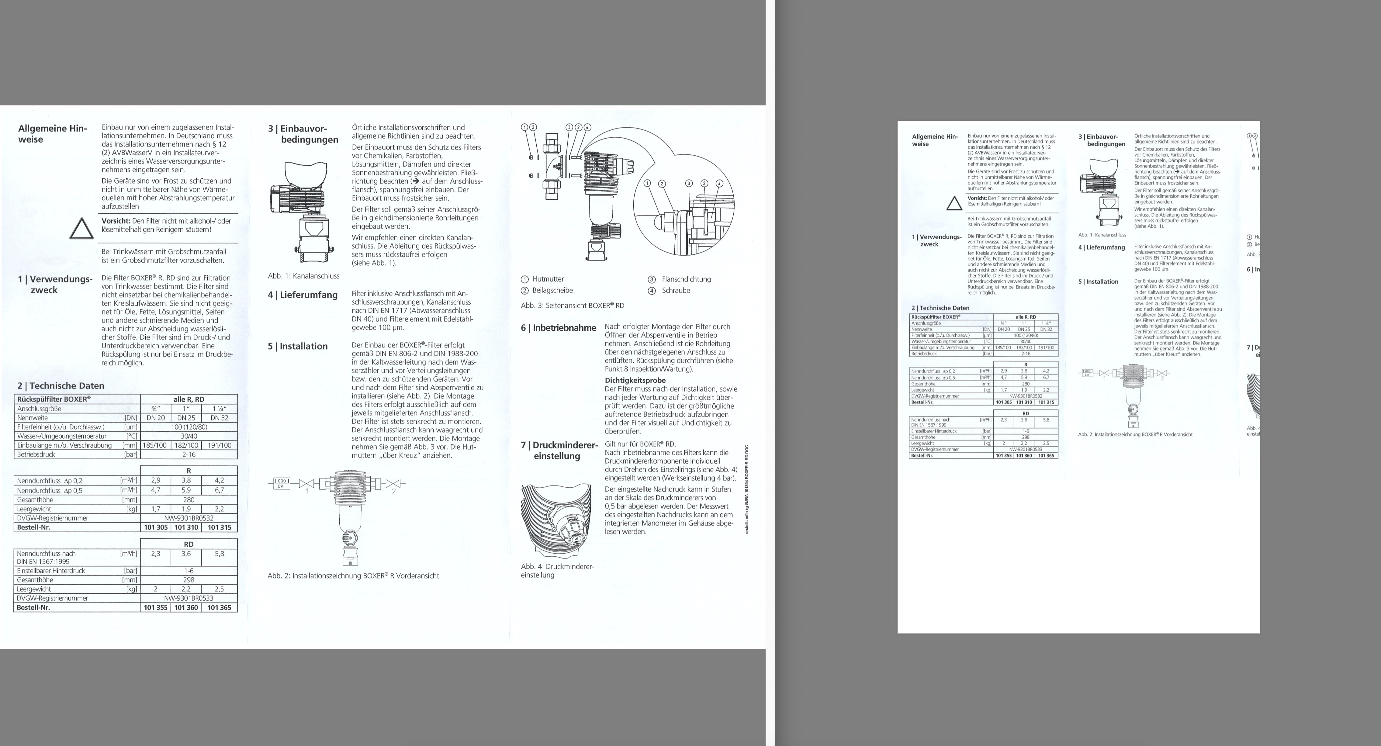

Repro:
Try to convert the attached File to PDF+Text
=> Rotation of the Document is wrong -> half of the document is missing
Repro:
I had a support ticket on a Hangul (Korean) conversion showing that issue but this OCR’d as expected. Take your original without OCR in the Finder, ZIP it, and upload the ZIP - just to preserve the exact file you were processing.
Maybe I´ve got to tell, that this was created with the beta1 of DT3
See before and after Screenshot - it isn´t like i would expect that.
ZIP FILE:
00000001-1.JPG.zip (4.0 MB)
Thanks! That is reproducible. Where did this image come from?
I´ve scanned it with a Xerox WorkCentre 6515DN
There’s a rotation applied in the image that appears to be messing this up.
Orientation : Rotate 90 CW
Development will have to look into whether this is a DEVONthink or ABBYY issue.
This is fixed and will be in next beta
