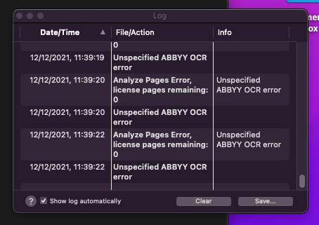

Also, I am getting this error a lot when trying to do OCR:
I don’t have any license pages remaining??

I followed the instructions in the thread posted above, but I am still getting the same problem:
It seems to work for a certain number of pages, then stops working and gives me that error. It says “license pages remaining”, so do we need to pay for a kind of license? It does seem to happen after I’ve done a good number of pages.
I searched here for “ocr license” and found OCR "license pages remaining: 0" - #3 by banshee which may help.
Thanks, but that is the same link that @xurc posted above, and it didn’t work for me.

Did you read the full thread I posted? The solution is indeed a temporary fix, you have to delete ~/Library/Application Support/DEVONthink/Abbyy every time the error occurs.
No. It’s a bug in ABBYY’s library and they’re already aware of it (source).
I did read the thread which you kindly posted; indeed I had commented on that thread also. It wasn’t clear to me from the thread however that the solution was just a temporary fix. I’m surprised that I’m unable to let the OCR run overnight due to this problem, and have to delete and reinstall the OCR component every day. Considering the cost of the software I had expected the OCR to work without issues.
It is indeed very frustrating. Although in DEVONtechnologies’ defense, there’s little they could do to alleviate the frustration since the bug is in ABBYY’s software library.
Thanks @xurc . Maybe consideration should be given to a different OCR API if ABBYY isn’t up to the job.
Sure but that’s also like considering rewiring part of your house. Is such a project doable? Sure. Easily and quickly done? Nope.
