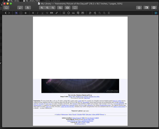

I also use Firefox and DevonThink3. I can clip sometimes but many times I only get a partial page of what I want to clip. I am using the single page PDF and the output format.
Clipping with DevonThink2 works fine.

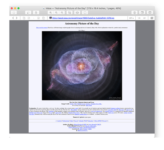

This is PDF (Single Page) from Firefox 66.0.3 in macOS Mojave 10.14.4.
Here is what I’m getting.
I have tried clearing the caches of both Firefox and Devonthink and done the capture several times. I am on the same versions of Firefox and Devonthink.
Did you enable the clutter-free option?
Voila!
