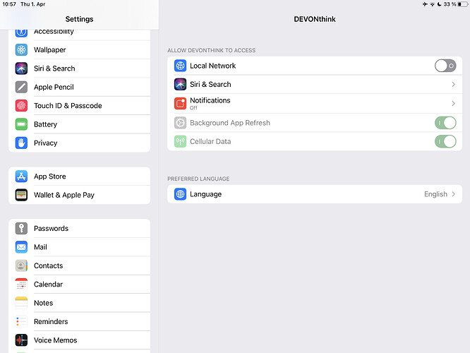

Open the iPad Setting, search for “DEVON” and check wether you enabled “Local Network”:

If you want to connect your iPad, check DTTG wether Bonjour is enabled is enabled in DTTG settings.
If you want the iPad to connect the Laptop, Bonjour needs to be enabled there (also not sure about the details)
At me, both are disabled, as I do not Sync locally.
