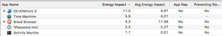

Was “bird” showing excessive energy or CPU use?
Absolutely:
Absolutely:
I have the same iCloud Upload and bird issue on corporate fibre connection and wired LAN:

Yes, “bird” was running nearly continuously while the stuck iCloud message was being displayed. I have an iMac Pro and it kept one of the 8 cores occupied about 80-90% of the time. I also noted that DT3 was consuming about 12% CPU as well, presumably doing whatever iCloud monitoring it does.
